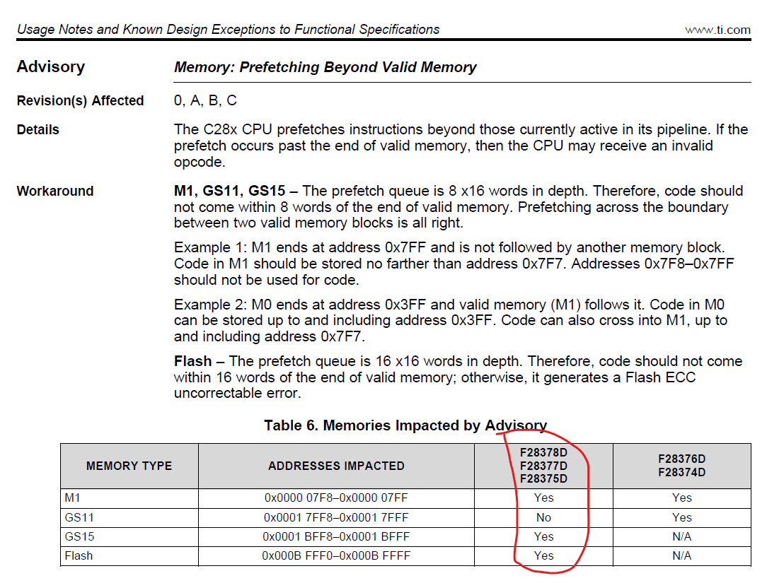

Hi, I'm trying to debug a difficult issue and wondering if anyone here has any insights into it.  My firmware application runs out of flash.  I had a bug in my linker file where the .pinit section was mapped to ram instead of flash.  The result of this was that my code would run fine when I programmed/debugged the code, but when I power cycled the board and booted from flash all of my global objects (c++ classes) were not initialized correctly.
After fixing this bug to have .pinit map to flash instead of ram, my program still runs correctly when I load it from the debugger, but when I power cycle the board and boot from flash nothing happens, as in, not even the first few lines of main seem to execute, judging based on an LED toggle.  I then commented out several of the global objects, and when I only have a few defined the program runs, but when I pass a certain threshold of global objects, it doesn't matter which objects in particular, nothing runs and the cpu seemingly gets locked before reaching the first few lines of main.
I'll attach my cmd file here.  Any suggestions on how to debug this further would be appreciated.

    One reason could be that that the watchdog gets reset before reaching the main function. The _c_int00 function which is called before the main function does the initialization of all the globals. If the watchdog is enabled and the size of globals is high, the watchdog might get reset
    Can you check if the watchdog is enabled or not in the CodeStartBranch.asm file. (In C2000ware v3.3.0 we have updated the file to ahve watchdog disabled by default)
    WD_DISABLE .set 1 ;set to 1 to disable WD, else set to 0
    Veena
  • Hi
    Please also be aware of the errata for this CPU: Memory: Prefetching Beyond Valid Memory
    I can see this is not handled in your cmd file.
    It took me awhile to find a similar problem with our target.
    If you download the latest C2000Ware from TI, you will find cmd examples where this is fixed.
