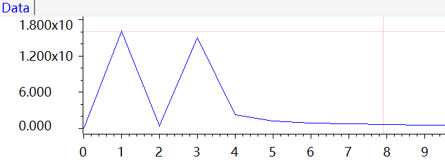

I'm using CFFT_f32s_mag_TMU0 function to calculate the FFT magnitude of a pretty simpe waveform which contains 1Hz and 3Hz components. As attached below, the graph shows a clear result:

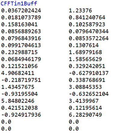

And what the function gives me is:

  1. Why the result is inconsistent?
  2. Why would negeative number appears, since the magnitude should calculate sqrt(Xre[i]2 + Xim[i]2).
Any relpy is appreciated.

    The first quesiton was resolved. I did not pass the imaginary part into the CFFT. But I'm still curious why would the magnitude function gives negative result.

  • Hi Himanshu,
    I've checked all above points and the size of FFT is 32. And I do not think this is related to the second question. Anyway, thanks for the response.
