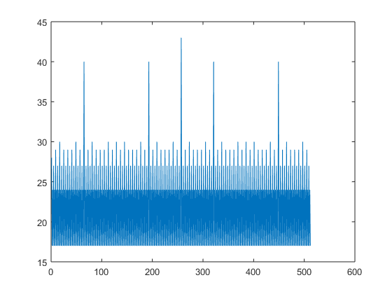

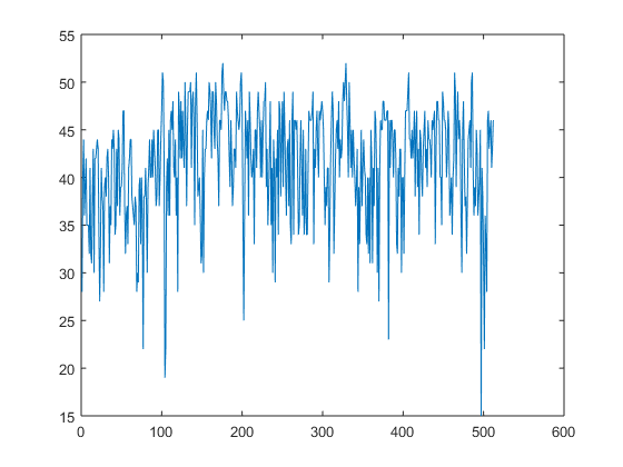

I'm using RFFT_f32 FFT on F280049. FFT size is 1024.
Using HAMMING1024, Not using USE_TABLES (Twiddle factor table?)
When I download program to FLASH with XDS100i, It works good.
But after power up without JTAG?, the FFT result get crazy.
I got a message when I build.
warning #10247-D: creating output section "FPUmathTables" without a SECTIONS specification
warning #10210-D: creating ".esysmem" section with default size of 0x400; use the -heap option to change the default size
And I add description to generic_flash_lnk.cmd
FPUTABLES : origin = 0x3FEBDC, length = 0x0006A0 /* FPU Tables in Boot ROM
FPUmathTables : > FPUTABLES, PAGE = 0, TYPE = NOLOAD
But the FFT return 95% of 32767.
    In order to use RAM_ROMTABLES configuration, you must set USE_TABLES = 1 in the predefined symbols setting. Also, you must include the bootROM symbols lib as applicable as stated in the documentation. It is possible that incorrectly accessing the tables is contributing to your error.
