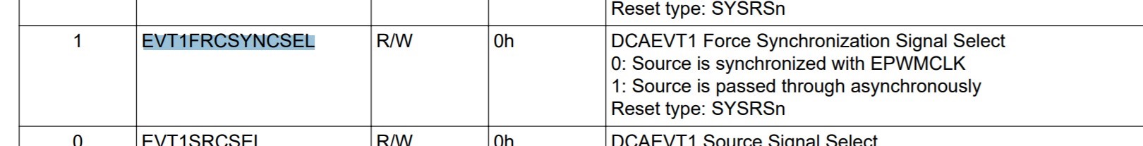

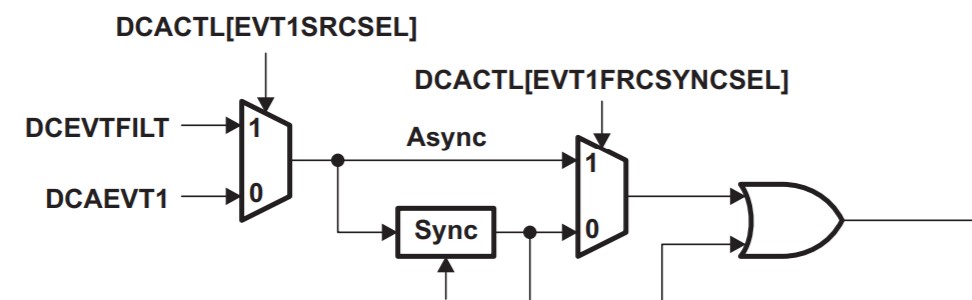

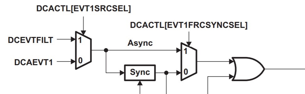

If we refer to F280049 TRM(SPRUI33D), Figure 18-51(DCAEVT1 Event Triggering) shows us EVT1FRCSYNCSEL = 1 for Async and 0 for Sync(to TBCLK), but Table 18-88(DCACTL Register Field Descriptions) shows us that source is synchronized with EPWMCLK if EVT1FRCSYNCSEL = 1.
Please advise which description we should refer to, thanks for your help.
