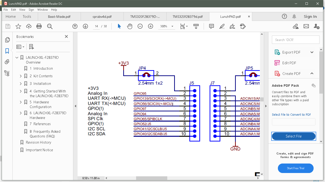

    SCI_Mode Connection:
    Here you are mentioned Controlcard need to be connect with mini-USB , In Launchpad F28379D  after selecting pins(BOOT MODE )   need to use  external USB to RS232 TTL converter though  pin GPIO139,GPIO56 is this correct for connect with PC COM port .

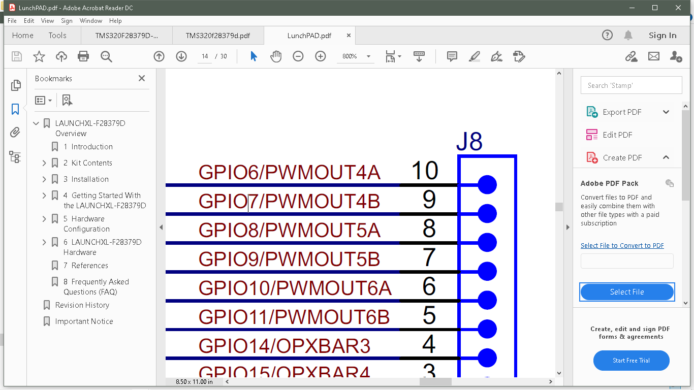

    In Launchpad have GPIO8/9 are SCI-A pins Can I use this.
    Can I use this other SCI-A pins here to implement SCI_Mode

  • Rani,
    Based on the language of the Launchpad user's guide, it would appear to me that the approach you are suggesting - i.e. using GPIOs other than 84/85 or 28/29 is not feasible. I think SCIA pins other than these would not be valid SCI boot mode pins.
    I am checking with a HW expert about whether my understanding is correct.
  • I also heard back from the HW expert, essentially confirming my statements.
    SCI boot only works with the below GPIOs. These GPIOs are not brought out to any of the headers on the LaunchPad board so the customer cannot access them (BGA package makes it impossible to blue wire).
