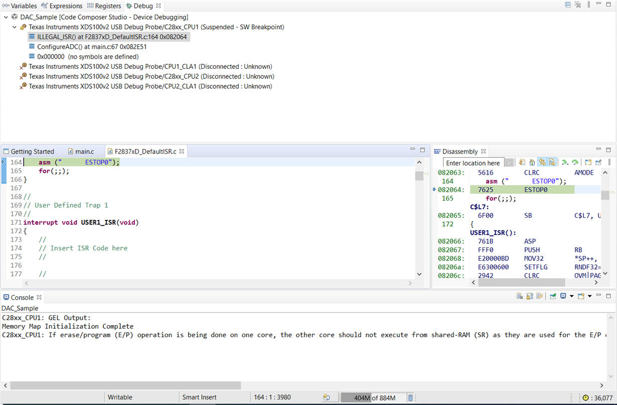

Hello, I am fairly new to TMS320F28379D. I am facing a problem while running a DAC code in CCS. When I run the code the (main.c) the program goes into the line 164 of F28379D_DefaultISR.c (asm("    ESTOP0").

This is a fairly simple code which will update the DACVALS register every 2 seconds. Initial Value at DACVALS is 100 and then every 2 seconds 500 is added to the previous value which was in DACVALS. I have attached the picture of the files included in my project and also the error (not exactly error) but some program is breaking and coming to Default ISR as shown in the picture.This problem occurs only when I am running a DAC code and any other code will work fine.
However in the Program, if I comment out the DELAY_US(500) (Comment out in the sense, if I delete that particular line). , Then the program runs fine , and i don't see any break in the program.
It is very simple code to update the DACVALS every 2 seconds.
