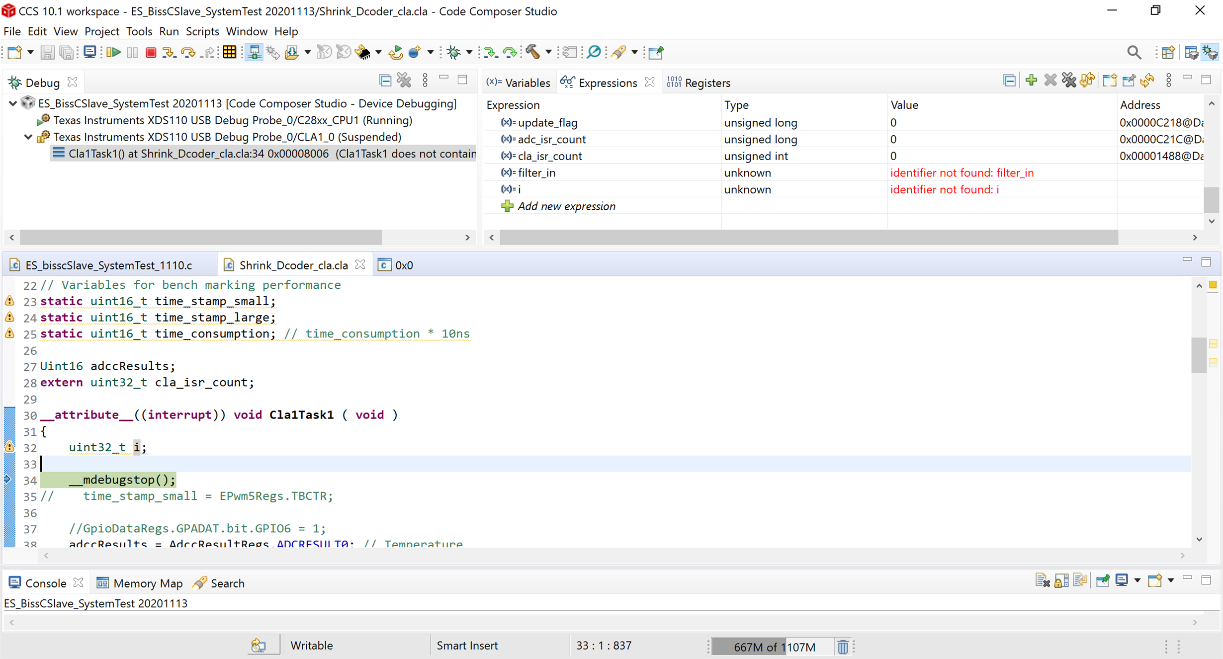

I can watch CLA task's local variable in CCS expression window in example project "cla_ex2_background_task" while I can not watch them in my own. Did I miss any setting or configurations here?

Hi Sheldon,
Did you build your project with optimization enabled? This is common with optimization:
https://dev.ti.com/tirex/explore/node?node=AEm7LJjS34iFPa5fpT7ttQ__FUz-xrs__LATEST
