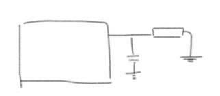

    Thanks for your feedback, we get more findings here and would like to share with you.
    We have DAC test circuit connection like above. We put capacitance to 10nF and resistance to 1k then we get what I mentioned in previous thread,
    When we change resistor from 1k to 10k, the issue in no more existing. (three ADC get almost the same numeric value). Do you have any idea of what happens behind?

  • Hi Sheldon,

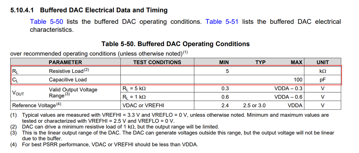

    There are limits to the size of the capacitive load and the resistive load the DAC can drive.  10nF + 1kohm violates the capacitive loading spec's and reduces the usable range while 10nF + 10kohm only violates the capacitive loading spec'.
    You might try 10k + 100pF and 1k + 100pF.

    In the case of a resistance that is too small, the output buffer can't handle the current load, resulting in non-linear behavior of the DAC buffer.
    In the case of an excessively large capacitive load, the DAC buffer may become unstable or may have other issues driving the load.
    In either case, ADC sampling is a dynamic event (the ADC input is not high impedance) so even small differences between the impedances can be amplified, especially if the ADC driver is weak and has to drive 3 ADCs simultaneously.
