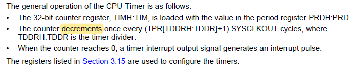

1.  Is CPU timer0 working in up-counting fashion or up-down counting fashion?
    The behavior is described in the TRM and demonstrated by the timed_led_blink example in C2000Ware.
