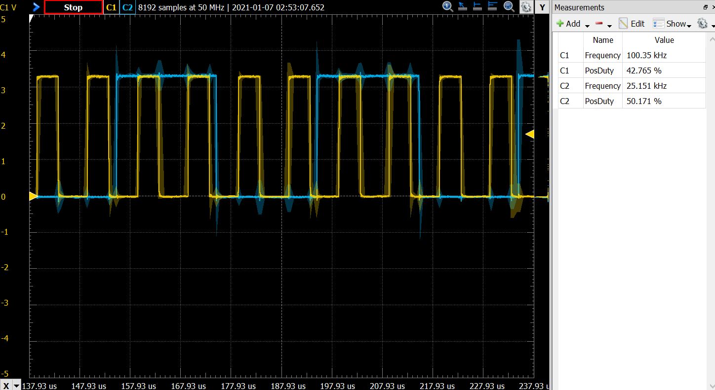

Hi
I am using the LaunchXL-F28027F.
I'm trying to trigger ADC sampling through ePWM. I want each ADC sampled at the center of the PWM on pulse. My PWM configuration and ADC configuration is shown below.
I have configured a GPIO interrupt inside adc_isr() to indicate the sampled instances. But when I look at the oscilloscope waveforms I see that the ADC is sampled every other PWM cycle instead of every PWM cycle. How can I fix this? Could you please help?

  • I have more to add to this question.
    Firstly, the code for PWM config that I have posted here is incorrect. Below is the correct code.
    Also, I observed that if I reduce the PWM frequency to lower than 85 or so, I get proper ADC sampling at every PWM cycle. But if I increase it above 85, I start losing samples after a few PWM cycles and at 100kHz, I see sampling at every 2nd PWM cycle instead of every PWM cycle. Some screenshots have been attached below.
    I am not sure why this is happening? Is it because of the ADC sampling, hold and conversion time getting too close to the PWM period?

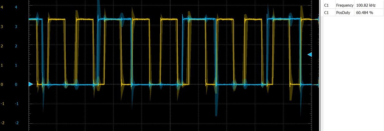

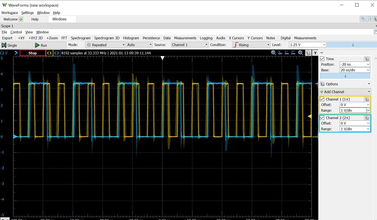

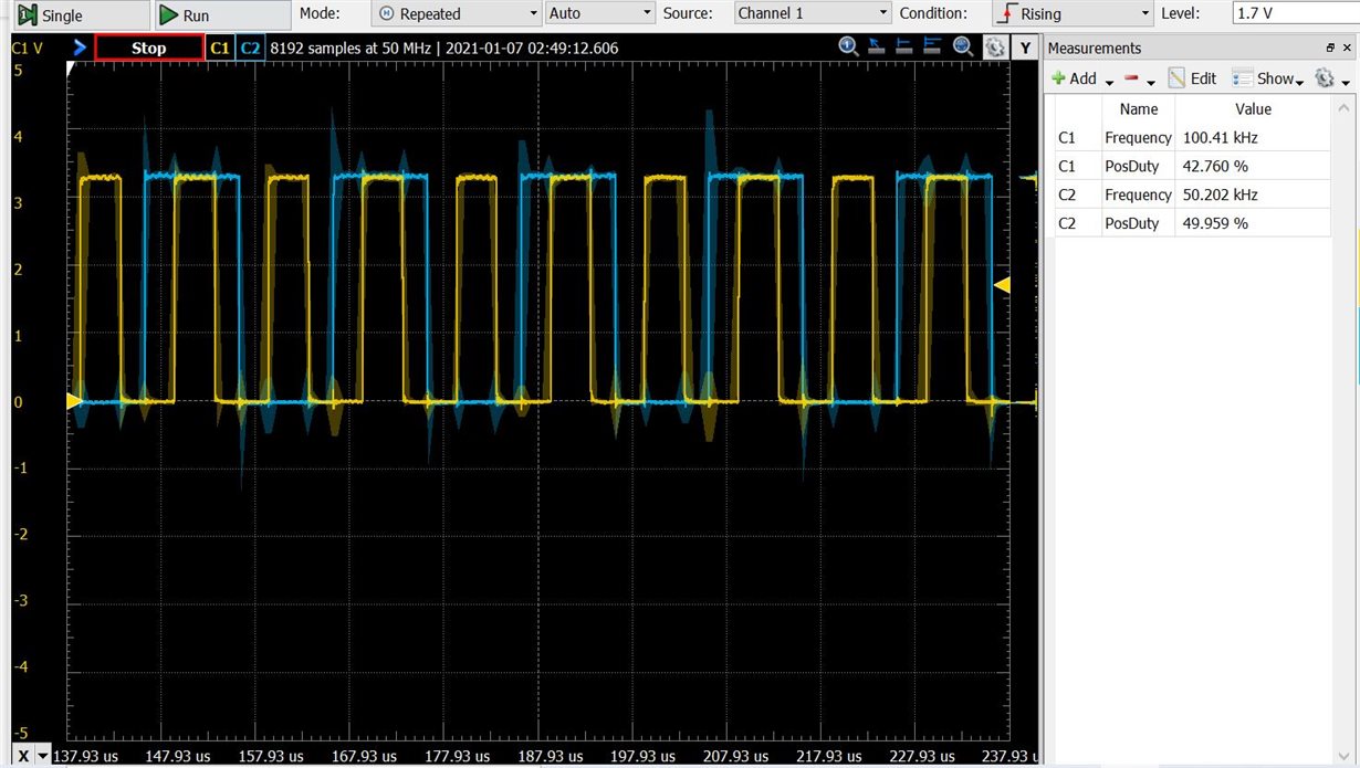

    Waveforms at 85kHz, (Blue is GPIO toggle in the ADC ISR and Yellow is PWM) - ADC Sampled correctly at every PWM interval.
    Waveform at 90kHz, (Blue is GPIO toggle in the ADC ISR and Yellow is PWM) - Samples missed after every 8 cycles.
    Waveform at 100kHz, (Blue is GPIO toggle in the ADC ISR and Yellow is PWM) - Sampled only at every alternate cycle.

    Waveform screenshots at different frequencies.
    Waveform at 90kHz, (Blue is GPIO toggle in the ADC ISR and Yellow is PWM) - Samples missed after every 7 cycles.

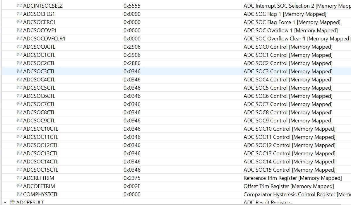

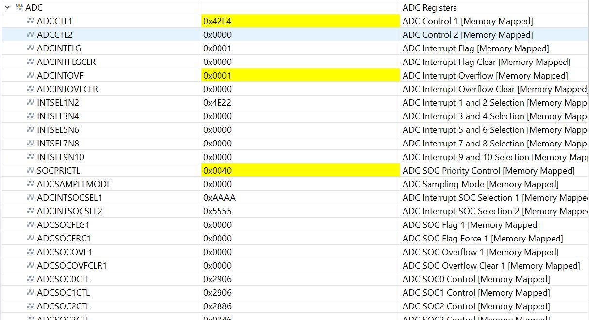

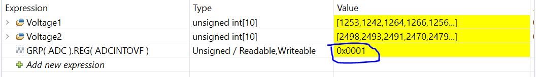

  • Can you see the ADCINTOVF flag getting set? If so can you clear it in your ISR and see what effect that has? ADCINTOVF being set can disrupt the normal generation of interrupts.
    Whitney
  • Thank you for the response.
    Yes. The ADCINTOVF flag was being set.
    I cleared this flag right after I clear ADCINT1 at the bottom of the ISR ,and there seems to be little improvement in that I can't see the Overflow flag being set in the watch window (when execution paused), but my sampling still takes 2 cycles every now and then. Screenshot below:
    Updated code snippet:
    // Clear ADCINT1 flag reinitialize for next SOC
    AdcRegs.ADCINTFLGCLR.bit.ADCINT1 = 1;
    AdcRegs.ADCINTOVFCLR.bit.ADCINT1 = 1;
    AdcRegs.ADCINTOVFCLR.bit.ADCINT2 = 1;
    Clearing this anywhere else doesn't seem to solve the problem.
    Any suggestion?  Do you need anymore information from my side?
    Shamanth
  • Thanks for your patience while I was out of the office. The fact that the overflow flag is getting set in the first place does seem to indicate that the conversions and interrupt handling aren't quite getting handled in time. Can you share the rest of your ADC configuration? Maybe share a screen capture of the ADC registers in the CCS Registers view? Are you just calling InitAdc() and AdcOffsetSelfCal() before the code you've shared above?
    Whitney

  • Thanks for sharing your code. Could you still share a screen capture of your ADC registers though? I unfortunately don't have a F28027F board with me at the moment and can't try out your code myself.
    Whitney
  • As I have been testing more on this, I have more information to provide:
    The issue seems to happen when I switch to execute from Flash instead of RAM.
    So I started from the example code, Example_F2802xAdcSoc:
    When I run the code from RAM, I get what I need without any overflow.
    But.
    When I change the execution to Flash, I see missed samples with overflow.
    Is there some function that I need to move to RAM? I need the code to be executed from Flash itself.
    Shamanth
  • Try clearing the ADCINTSOCSEL registers. If additional SOCs are being triggered by INT1, it could be causing a delay in when the ones you're actually interested in are ready.
    You may want to move your ADC ISR to RAM too to make sure it's executing as quickly as possible.
    Whitney
    I tried both the above recommendations and it did not work.
    Attached is the updated code. I tried clearing ADCINTSOCSEL both in main and the IDC_ISR.
    I also added a #pragma to move adc_isr() to RAM. I can confirm that ADC_ISR Is in RAM from the map file that has been generated. Also attached.
    Something about moving the code to Flash is making the whole thing to fail.

    CLK_Handle myClk;
    FLASH_Handle myFlash;
    GPIO_Handle myGpio;
    PIE_Handle myPie;
    PWM_Handle myPwm;
    // Main
    void main(void)
        CPU_Handle myCpu;
        PLL_Handle myPll;
        WDOG_Handle myWDog;
        // Initialize all the handles needed for this application
        myAdc = ADC_init((void *)ADC_BASE_ADDR, sizeof(ADC_Obj));
        myClk = CLK_init((void *)CLK_BASE_ADDR, sizeof(CLK_Obj));
        myCpu = CPU_init((void *)NULL, sizeof(CPU_Obj));
        myFlash = FLASH_init((void *)FLASH_BASE_ADDR, sizeof(FLASH_Obj));
        myGpio = GPIO_init((void *)GPIO_BASE_ADDR, sizeof(GPIO_Obj));
        myPie = PIE_init((void *)PIE_BASE_ADDR, sizeof(PIE_Obj));
        myPll = PLL_init((void *)PLL_BASE_ADDR, sizeof(PLL_Obj));
        myPwm = PWM_init((void *)PWM_ePWM1_BASE_ADDR, sizeof(PWM_Obj));
        myWDog = WDOG_init((void *)WDOG_BASE_ADDR, sizeof(WDOG_Obj));
        // Perform basic system initialization
        WDOG_disable(myWDog);
        CLK_enableAdcClock(myClk);
        (*Device_cal)();
        CLK_disableAdcClock(myClk);
        // Select the internal oscillator 1 as the clock source
        CLK_setOscSrc(myClk, CLK_OscSrc_Internal);
        // Setup the PLL for x10 /2 which will yield 50Mhz = 10Mhz * 10 / 2
        PLL_setup(myPll, PLL_Multiplier_12, PLL_DivideSelect_ClkIn_by_2);
        // Disable the PIE and all interrupts
        PIE_disable(myPie);
        PIE_disableAllInts(myPie);
        CPU_disableGlobalInts(myCpu);
        CPU_clearIntFlags(myCpu);
        // If running from flash copy RAM only functions to RAM
    #ifdef _FLASH
        memcpy(&RamfuncsRunStart, &RamfuncsLoadStart, (size_t)&RamfuncsLoadSize);
    #endif
        //Initialize the GPIO
        //GPIO Initialize
        GPIO_setPullUp(myGpio, GPIO_Number_0, GPIO_PullUp_Disable);
        GPIO_setMode(myGpio, GPIO_Number_0, GPIO_0_Mode_EPWM1A);
        GPIO_setPullUp(myGpio, GPIO_Number_19, GPIO_PullUp_Disable);
        GPIO_setMode(myGpio, GPIO_Number_19, GPIO_19_Mode_GeneralPurpose);
        GPIO_setDirection(myGpio, GPIO_Number_19, GPIO_Direction_Output);
        GPIO_setHigh(myGpio, GPIO_Number_19);
        // Setup a debug vector table and enable the PIE
        PIE_setDebugIntVectorTable(myPie);
        PIE_enable(myPie);
        CLK_disableTbClockSync(myClk);
        // Register interrupt handlers in the PIE vector table
        PIE_registerPieIntHandler(myPie, PIE_GroupNumber_10, PIE_SubGroupNumber_1,
                                    (intVec_t)&adc_isr);
        // Initialize the ADC
        InitAdc();  // For this example, init the ADC
        AdcOffsetSelfCal();
        // Enable ADCINT1 in PIE
        PIE_enableAdcInt(myPie, ADC_IntNumber_1);
        // Enable CPU Interrupt 1
        CPU_enableInt(myCpu, CPU_IntNumber_10);
        // Enable Global interrupt INTM
        CPU_enableGlobalInts(myCpu);
        // Enable Global realtime interrupt DBGM
        CPU_enableDebugInt(myCpu);
        LoopCount = 0;
        ConversionCount = 0;
        // Configure ADC
        // Note: Channel ADCINA4  will be double sampled to workaround the ADC 1st
        // sample issue for rev0 silicon errata
        // ADCINT1 trips after AdcResults latch
        ADC_setIntPulseGenMode(myAdc, ADC_IntPulseGenMode_Prior);
        ADC_enableInt(myAdc, ADC_IntNumber_1);              // Enabled ADCINT1
        // Disable ADCINT1 Continuous mode
        ADC_setIntMode(myAdc, ADC_IntNumber_1, ADC_IntMode_ClearFlag);
        // setup EOC2 to trigger ADCINT1 to fire
        ADC_setIntSrc(myAdc, ADC_IntNumber_1, ADC_IntSrc_EOC0);
        // set SOC0 channel select to ADCINA4
        ADC_setSocChanNumber (myAdc, ADC_SocNumber_0, ADC_SocChanNumber_A4);
        // set SOC2 channel select to ADCINA2
        ADC_setSocChanNumber (myAdc, ADC_SocNumber_2, ADC_SocChanNumber_A2);
        // set SOC1 channel select to ADCINA4
        ADC_setSocChanNumber (myAdc, ADC_SocNumber_1, ADC_SocChanNumber_A4);
        // set SOC0 start trigger on EPWM1A, due to round-robin SOC0 converts first
        // then SOC1
        ADC_setSocTrigSrc(myAdc, ADC_SocNumber_0, ADC_SocTrigSrc_EPWM1_ADCSOCA);
        // set SOC1 start trigger on EPWM1A, due to round-robin SOC0 converts first
        // then SOC1
        ADC_setSocTrigSrc(myAdc, ADC_SocNumber_1, ADC_SocTrigSrc_EPWM1_ADCSOCA);
        // set SOC2 start trigger on EPWM1A, due to round-robin SOC0 converts first
        // then SOC1, then SOC2
        ADC_setSocTrigSrc(myAdc, ADC_SocNumber_2, ADC_SocTrigSrc_EPWM1_ADCSOCA);
        // set SOC0 S/H Window to 14 ADC Clock Cycles, (13 ACQPS plus 1)
        ADC_setSocSampleWindow(myAdc, ADC_SocNumber_0,
                               ADC_SocSampleWindow_7_cycles);
        // set SOC1 S/H Window to 14 ADC Clock Cycles, (13 ACQPS plus 1)
        ADC_setSocSampleWindow(myAdc, ADC_SocNumber_1,
        // set SOC2 S/H Window to 14 ADC Clock Cycles, (13 ACQPS plus 1)
        ADC_setSocSampleWindow(myAdc, ADC_SocNumber_2,
        // Setup each SOC's ADCINT trigger source
        AdcRegs.ADCINTSOCSEL1.all  = 0x00;    //No ADCINT will trigger SOCx.
        AdcRegs.ADCINTSOCSEL2.all  = 0x00;    //No ADCINT will trigger SOCx.
        // Enable PWM clock
        CLK_enablePwmClock(myClk, PWM_Number_1);
        // Setup PWM
        PWM_enableSocAPulse(myPwm);                     // Enable SOC on A group
        // Select SOC from from CPMA on upcount
        PWM_setSocAPulseSrc(myPwm, PWM_SocPulseSrc_CounterEqualCmpAIncr);
        // Generate pulse on 1st event
        PWM_setSocAPeriod(myPwm, PWM_SocPeriod_FirstEvent);
        PWM_setPeriodLoad(myPwm, PWM_PeriodLoad_Immediate);
        PWM_setPeriod(myPwm, 0x258);                    // Set period for ePWM1
        PWM_setCmpA(myPwm, 0x100);                      // Set compare A value
        PWM_setPhase(myPwm, 0x0000);       // Phase is 0
        PWM_setCount(myPwm, 0x0000);
        PWM_setCounterMode(myPwm, PWM_CounterMode_Up);   // count up and start
        // Clock ratio to SYSCLKOUT
        PWM_setHighSpeedClkDiv(myPwm, PWM_HspClkDiv_by_1);
        PWM_setClkDiv(myPwm, PWM_ClkDiv_by_1);
           // Clear counter
        // Load registers every ZERO
        PWM_setShadowMode_CmpA(myPwm, PWM_ShadowMode_Shadow);
        PWM_setShadowMode_CmpB(myPwm, PWM_ShadowMode_Shadow);
        PWM_setLoadMode_CmpA(myPwm, PWM_LoadMode_Zero);
        PWM_setLoadMode_CmpB(myPwm, PWM_LoadMode_Zero);
        PWM_setActionQual_CntUp_CmpA_PwmA(myPwm, PWM_ActionQual_Clear);
        PWM_setActionQual_Period_PwmA(myPwm, PWM_ActionQual_Set);
        CLK_enableTbClockSync(myClk);
        // Wait for ADC interrupt
        for(;;)
            LoopCount++;
    // adc_isr -
    #pragma CODE_SECTION(adc_isr, "ramfuncs");
    __interrupt void
    adc_isr(void)
        // discard ADCRESULT0 as part of the workaround to the 1st sample errata
        // for rev0
        Voltage1[ConversionCount] = ADC_readResult(myAdc, ADC_ResultNumber_1);
        Voltage2[ConversionCount] = ADC_readResult(myAdc, ADC_ResultNumber_2);
        GPIO_toggle(myGpio, GPIO_Number_19);
        // If 10 conversions have been logged, start over
        if(ConversionCount == 9)
        else
            ConversionCount++;
        ADC_clearIntFlag(myAdc, ADC_IntNumber_1);
        // Acknowledge interrupt to PIE
        PIE_clearInt(myPie, PIE_GroupNumber_10);
        return;
    // End of File

  • I think ADCINTSOCSELx are EALLOW protected. Make sure the writes are actually going through.
    Judging from your map file, it looks like all of the functions called by your ISR are being inlined appropriately except for GPIO_toggle(). You could make it inline as well to make sure it's executed from RAM and not taking on the overhead of the function call. I'd be surprised if that one function would be enough to cause the issue though.
