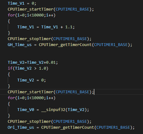

Dear Champs,
I am asking this for our customer.
The user is optimizing their codes in speed.
They tried to compare the speed of a simple addition on FPU and sin() on TMU and found sin() is faster than the addition (i += 1.1).
Just wonder it makes sense?
Do you have any comment?

  • Wayne,
    I presume optimization is disabled? Can you look at the disassembly? That will tell you what is going on. Float add is 1 cycle, and sinpuf32 is 4 cycles. So surely there are multiple instructions involved (e.g. for the add, read, add, store). The sine loop is operating on the same value, the compiler might optimize this but it depends on the settings and if Time_V2 is a volatile. The numbers are in the same range, so that tells me the compiler isn't optimizing it out.

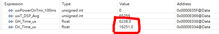

  • Dear Sira,
    The user was doing more labs.
    CPU Timer period is 100000.
    That is, if GH_Timer_us is 90000, it means addition takes 100000-90000 = 10000 counts.
    If Ori_Time_us is 90000, it means sin() takes 100000-90000 = 10000 counts.
    Compiler is V18.12.7.LTS
    Addition is changed to "Time_V1 = Time_V1 + Timer_V1;"
    For loop is changed to 2000 times to avoid underflow.
    1. If it's without optimization, the result shows the time for addition is similar to that for sin().
    2. Much to our surprise, the result shows the time for sin() is much shorter than that for addition if below optimization is used.
    Wayne Huang
  • Wayne,
    So basically in the case with optimization, the sine loop takes about 8000 cycles, for 2000 iterations i.e. 4 cycles/iteration, which is how long the sinpuf32 instruction takes.
    In the case with optimization, the add loop takes about 14000 cycles, for 2000 iterations i.e. 7 cycles/iteration.

    Meanwhile, can you tell me what how Time_V1 is defined. Is it a volatile float?
    Sira
  • Dear Sira,
    It's as follows.
    float  Time_V1, Time_V2, Time_V0;
    Wayne Huang
  • Wayne,
    The compiler is generating instructions that basically do the following:
    write the result to memory (R0H -> memory)
    load a register from the same memory location (memory -> R1H) - this results in a stall given the above write operation needs to finish
    perform the addition (R0H = R0H + R1H) - this is anyway a 2p cycle instruction
    Sira
