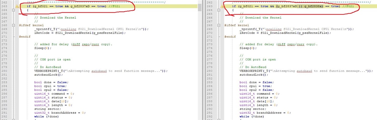

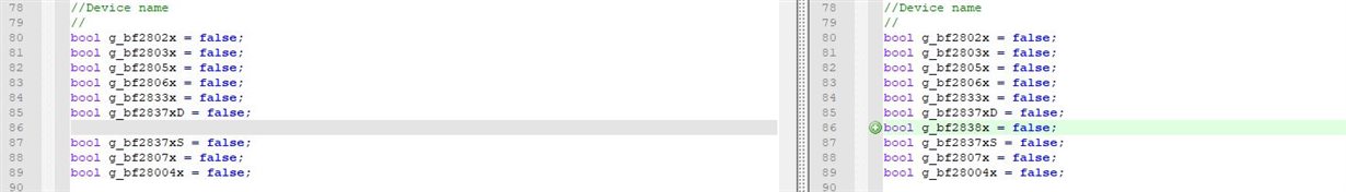

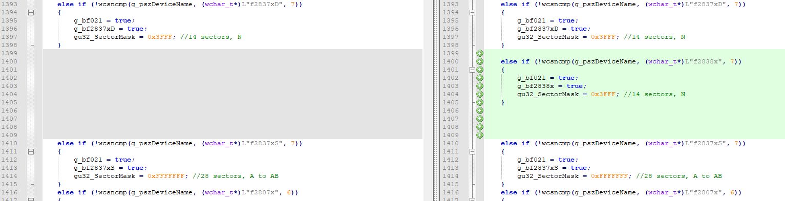

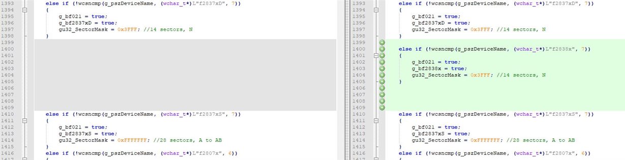

    Yes, the CPU1 and CPU2 portions of the F28388D flash kernels can be created by modifying the F2837xD versions.
    The serial_flash_programmer project in the same folder as the serial_flash_programmer.exe file can be modified in Visual Studio to add f2838x as a device. The project was made using the 2019 version of Visual Studio, so I would recommend using that.
    Anu
  • Dear Anu,

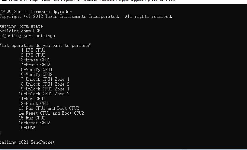

    My experiment was implemented on TMS320F28388D controlCARD.
    I tried to run the serial_flash_programmer.exe on my computer,
    and I used the .txt file generated from F2837XD_sci_flash_kernales_cpu01 project
    and another .txt file from my application project by the following command on PC.
    serial_flash_programmer.exe -d f2837xd -k kernel.txt -a app.txt p COM12 -B 9600
    it seemed that the SCI worked and the .txt file can be transferred via SCI port
    But the kernel can not be loaded.

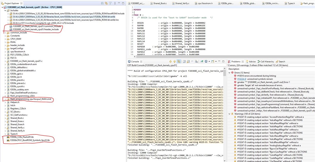

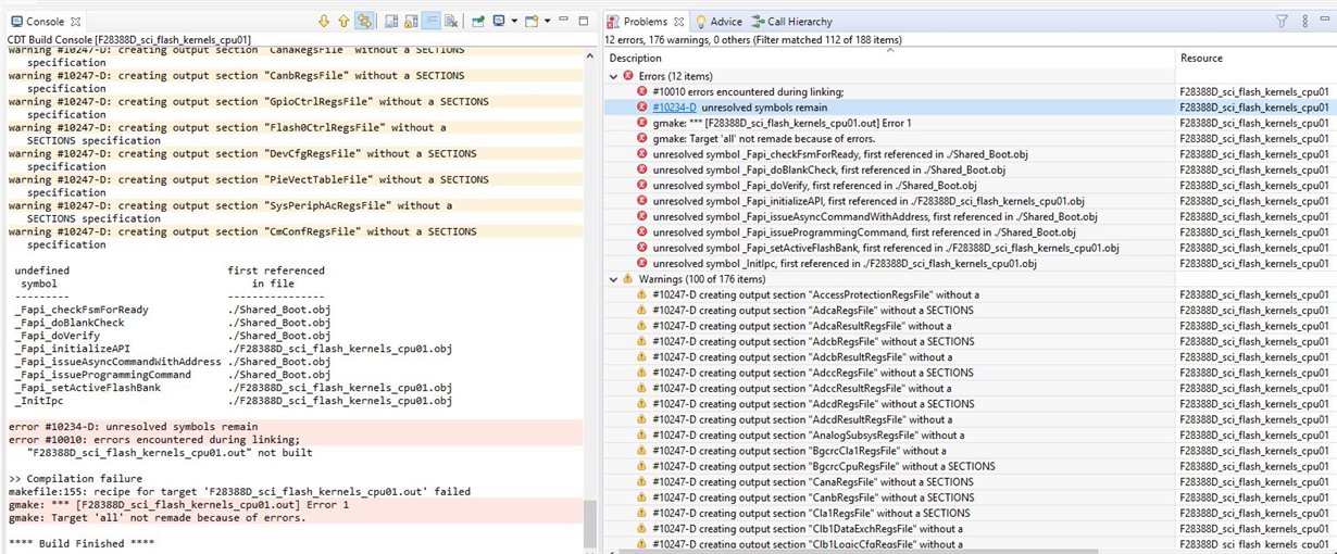

  • So, I tried to modify the F2837XD_sci_flash_kernels_cpu01 project and create a kernel project for F28388D.
    all the library files and headers files were replaced by the F28388 related files.
    The project is as follows,
    but I really do not know how c1bootROM _BootROMSymbls_fpu32.lib was generated.
    and what should I do for 28388 kernel project.
    The errors are as follows,
    so I am a little lost.
    Could you please give some clues on how to modify the F2837XD_sci_flash_kernels_cpu01 to the F28388 sci kernel project?
    Thanks very much!
    zhou ping
  • Zhou,
    For F28388D, you need the F2838xCPU1_BootROM_Symbols_fpu32.lib file (found at C2000Ware_3_03_00_00\libraries\boot_rom\f2838x\revA\rom_symbol_libs\cpu1\bootROM).
    In addition, c1_bootrom.h needs to be replaced by cpu1bootrom.h (C2000Ware_3_03_00_00\libraries\boot_rom\f2838x\revA\rom_sources\cpu1\F2838x_ROM\bootROM\include).
    One more file that should be replaced is the fwupgradec1toc2_start.asm, you can use f2838x_codestartbranch.asm (C2000Ware_3_03_00_00\device_support\f2838x\common\source).
    The Fapi_UserDefinedFunction.c file is not needed, and InitIpc() is not defined for F2838x. Please look at the IPC examples for F2838x in order to see how IPC modules are initialized.

  • Dear Anu,
    I created the f28388_sci_kernal_project as follows,
    I copy the header files for f28388 from the installation directory(C2000Ware_3_03_00_00\device_support\f2838x\common\include  AND C2000Ware_3_03_00_00\device_support\f2838x\headers\include) to my project directory.
    and both the F2838x_C28x_FlashAPI.lib and F2838Xcpu1_BootROM_Symbols_fpu32.lib are added to the project.
    And the same .cmd file from 2837xd kernel project was used.
    Anything wrong, please correct me.
    Many thanks!

  • Dear Anu,
    The Console log for my project is as follows,
    **** Build of configuration CPU1_RAM for project F28388D_sci_flash_kernels_cpu01 ****

    "../F28388D_sci_flash_kernels_cpu01.c", line 140: warning #225-D: function "InitIpc" declared implicitly

    Invoking: C2000 Compiler
    "D:/ti/ccs1011/ccs/tools/compiler/ti-cgt-c2000_20.2.1.LTS/bin/cl2000" --cla_support=cla1 --float_support=fpu32 --tmu_support=tmu0 --vcu_support=vcu2 --opt_for_speed=2 --fp_reassoc=off --include_path="D:/ti/ccs1011/ccs/tools/compiler/ti-cgt-c2000_20.2.1.LTS/include" --include_path="D:/ti/c2000/C2000Ware_3_03_00_00/libraries/boot_rom/f2838x/revA/rom_sources/cpu1/F2838x_ROM/driverlib/inc" --include_path="D:/ti/c2000/C2000Ware_3_03_00_00/libraries/boot_rom/f2838x/revA/rom_sources/cpu1/F2838x_ROM/bootROM/include" --include_path="D:/ti/c2000/C2000Ware_3_03_00_00/libraries/boot_rom/f2838x/revA/rom_sources/cpu1/F2838x_ROM/driverlib" --include_path="D:/ti/ccs_proj/kernel_28388d/F28388D_sci_flash_kernels_cpu01/common_include" --include_path="D:/ti/ccs_proj/kernel_28388d/F28388D_sci_flash_kernels_cpu01/header_include" --define=CPU1 -g --diag_suppress=10063 --diag_warning=225 --display_error_number --gen_func_subsections=on --abi=coffabi --preproc_with_compile --preproc_dependency="f2838x_sysctrl.d_raw" "../f2838x_sysctrl.c"
    "../f2838x_sysctrl.c", line 301 (col. 35): advice #2615-D: (Performance) Use --fp_mode=relaxed to enable TMU hardware support for FP division.
    Finished building: "../f2838x_sysctrl.c"
    Building file: "../f2838x_usdelay.asm"
    "D:/ti/ccs1011/ccs/tools/compiler/ti-cgt-c2000_20.2.1.LTS/bin/cl2000" --cla_support=cla1 --float_support=fpu32 --tmu_support=tmu0 --vcu_support=vcu2 --opt_for_speed=2 --fp_reassoc=off --include_path="D:/ti/ccs1011/ccs/tools/compiler/ti-cgt-c2000_20.2.1.LTS/include" --include_path="D:/ti/c2000/C2000Ware_3_03_00_00/libraries/boot_rom/f2838x/revA/rom_sources/cpu1/F2838x_ROM/driverlib/inc" --include_path="D:/ti/c2000/C2000Ware_3_03_00_00/libraries/boot_rom/f2838x/revA/rom_sources/cpu1/F2838x_ROM/bootROM/include" --include_path="D:/ti/c2000/C2000Ware_3_03_00_00/libraries/boot_rom/f2838x/revA/rom_sources/cpu1/F2838x_ROM/driverlib" --include_path="D:/ti/ccs_proj/kernel_28388d/F28388D_sci_flash_kernels_cpu01/common_include" --include_path="D:/ti/ccs_proj/kernel_28388d/F28388D_sci_flash_kernels_cpu01/header_include" --define=CPU1 -g --diag_suppress=10063 --diag_warning=225 --display_error_number --gen_func_subsections=on --abi=coffabi --preproc_with_compile --preproc_dependency="f2838x_usdelay.d_raw" "../f2838x_usdelay.asm"
    Finished building: "../f2838x_usdelay.asm"
    Building target: "F28388D_sci_flash_kernels_cpu01.out"
    Invoking: C2000 Linker
    "D:/ti/ccs1011/ccs/tools/compiler/ti-cgt-c2000_20.2.1.LTS/bin/cl2000" --cla_support=cla1 --float_support=fpu32 --tmu_support=tmu0 --vcu_support=vcu2 --opt_for_speed=2 --fp_reassoc=off --define=CPU1 -g --diag_suppress=10063 --diag_warning=225 --display_error_number --gen_func_subsections=on --abi=coffabi -z -m"F28388D_sci_flash_kernels_cpu01.map" --stack_size=0x100 --warn_sections -i"D:/ti/ccs1011/ccs/tools/compiler/ti-cgt-c2000_20.2.1.LTS/lib" -i"D:/ti/ccs1011/ccs/tools/compiler/ti-cgt-c2000_20.2.1.LTS/include" --reread_libs --disable_auto_rts --display_error_number --xml_link_info="F28388D_sci_flash_kernels_cpu01_linkInfo.xml" --entry_point=code_start --rom_model -o "F28388D_sci_flash_kernels_cpu01.out" "./F28388D_sci_flash_kernels_cpu01.obj" "./Fapi_UserDefinedFunctions.obj" "./SCI_Boot.obj" "./SCI_GetFunction.obj" "./Shared_Boot.obj" "./Shared_Erase.obj" "./Shared_Verify.obj" "./f2838x_codestartbranch.obj" "./f2838x_defaultisr.obj" "./f2838x_globalvariabledefs.obj" "./f2838x_gpio.obj" "./f2838x_piectrl.obj" "./f2838x_pievect.obj" "./f2838x_sysctrl.obj" "./f2838x_usdelay.obj" "../F2838xCPU1_BootROM_Symbols_fpu32.lib" "../F2838x_C28x_FlashAPI.lib" "../flash_programming_cpu1tocpu2_RAM.cmd" -llibc.a
    <Linking>
    warning #10373-D: library "../F2838xCPU1_BootROM_Symbols_fpu32.lib" contains
    ELF object files which are incompatible with the TI-COFF output file.
    Ensure you are using the proper library.
    warning #10373-D: library "../F2838x_C28x_FlashAPI.lib" contains ELF object
    files which are incompatible with the TI-COFF output file. Ensure you are
    warning #10247-D: creating output section "EradCRCGlobalRegsFile" without a
    SECTIONS specification
    warning #10247-D: creating output section "RomPrefetchRegsFile" without a
    warning #10247-D: creating output section "RomWaitStateRegsFile" without a
    warning #10247-D: creating output section "EradCRC1RegsFile" without a SECTIONS
    specification
    warning #10247-D: creating output section "EradCRC2RegsFile" without a SECTIONS
    specification
    warning #10247-D: creating output section "EradCRC3RegsFile" without a SECTIONS
    specification
    warning #10247-D: creating output section "EradCRC4RegsFile" without a SECTIONS
    specification
    warning #10247-D: creating output section "EradCRC5RegsFile" without a SECTIONS
    specification
    warning #10247-D: creating output section "EradCRC6RegsFile" without a SECTIONS
    specification
    warning #10247-D: creating output section "EradCRC7RegsFile" without a SECTIONS
    specification
    warning #10247-D: creating output section "EradCRC8RegsFile" without a SECTIONS
    specification
    warning #10247-D: creating output section "SyncSocRegsFile" without a SECTIONS
    specification
    warning #10247-D: creating output section "TestErrorRegsFile" without a
    warning #10247-D: creating output section "DacaRegsFile" without a SECTIONS
    specification
    warning #10247-D: creating output section "DacbRegsFile" without a SECTIONS
    specification
    warning #10247-D: creating output section "DaccRegsFile" without a SECTIONS
    specification
    warning #10247-D: creating output section "CpuTimer0RegsFile" without a
    warning #10247-D: creating output section "CpuTimer1RegsFile" without a
    warning #10247-D: creating output section "CpuTimer2RegsFile" without a
    warning #10247-D: creating output section "EradHWBP1RegsFile" without a
    warning #10247-D: creating output section "EradHWBP2RegsFile" without a
    warning #10247-D: creating output section "EradHWBP3RegsFile" without a
    warning #10247-D: creating output section "EradHWBP4RegsFile" without a
    warning #10247-D: creating output section "EradHWBP5RegsFile" without a
    warning #10247-D: creating output section "EradHWBP6RegsFile" without a
    warning #10247-D: creating output section "EradHWBP7RegsFile" without a
    warning #10247-D: creating output section "EradHWBP8RegsFile" without a
    warning #10247-D: creating output section "Emif1ConfigRegsFile" without a
    warning #10247-D: creating output section "Emif2ConfigRegsFile" without a
    warning #10247-D: creating output section "XintRegsFile" without a SECTIONS
    specification
    warning #10247-D: creating output section "EradCounter1RegsFile" without a
    warning #10247-D: creating output section "EradCounter2RegsFile" without a
    warning #10247-D: creating output section "EradCounter3RegsFile" without a
    warning #10247-D: creating output section "EradCounter4RegsFile" without a
    warning #10247-D: creating output section "GpioDataReadRegsFile" without a
    warning #10247-D: creating output section "NmiIntruptRegsFile" without a
    warning #10247-D: creating output section "SciaRegsFile" without a SECTIONS
    specification
    warning #10247-D: creating output section "ScibRegsFile" without a SECTIONS
    specification
    warning #10247-D: creating output section "ScicRegsFile" without a SECTIONS
    specification
    warning #10247-D: creating output section "ScidRegsFile" without a SECTIONS
    specification
    warning #10247-D: creating output section "SpiaRegsFile" without a SECTIONS
    specification
    warning #10247-D: creating output section "SpibRegsFile" without a SECTIONS
    specification
    warning #10247-D: creating output section "SpicRegsFile" without a SECTIONS
    specification
    warning #10247-D: creating output section "SpidRegsFile" without a SECTIONS
    specification
    warning #10247-D: creating output section "XbarRegsFile" without a SECTIONS
    specification
    warning #10247-D: creating output section "DcsmZ2OtpRegsFile" without a
    warning #10247-D: creating output section "EradGlobalRegsFile" without a
    warning #10247-D: creating output section "EscssConfigRegsFile" without a
    warning #10247-D: creating output section "HRCap6RegsFile" without a SECTIONS
    specification
    warning #10247-D: creating output section "HRCap7RegsFile" without a SECTIONS
    specification
    warning #10247-D: creating output section "AdcaResultRegsFile" without a
    warning #10247-D: creating output section "AdcbResultRegsFile" without a
    warning #10247-D: creating output section "AdccResultRegsFile" without a
    warning #10247-D: creating output section "AdcdResultRegsFile" without a
    warning #10247-D: creating output section "SysStatusRegsFile" without a
    warning #10247-D: creating output section "DmaClaSrcSelRegsFile" without a
    warning #10247-D: creating output section "PieCtrlRegsFile" without a SECTIONS
    specification
    warning #10247-D: creating output section "Cmpss1RegsFile" without a SECTIONS
    specification
    warning #10247-D: creating output section "Cmpss2RegsFile" without a SECTIONS
    specification
    warning #10247-D: creating output section "Cmpss3RegsFile" without a SECTIONS
    specification
    warning #10247-D: creating output section "Cmpss4RegsFile" without a SECTIONS
    specification
    warning #10247-D: creating output section "Cmpss5RegsFile" without a SECTIONS
    specification
    warning #10247-D: creating output section "Cmpss6RegsFile" without a SECTIONS
    specification
    warning #10247-D: creating output section "Cmpss7RegsFile" without a SECTIONS
    specification
    warning #10247-D: creating output section "Cmpss8RegsFile" without a SECTIONS
    specification
    warning #10247-D: creating output section "DcsmCommonRegsFile" without a
    warning #10247-D: creating output section "PmbusaRegsFile" without a SECTIONS
    specification
    warning #10247-D: creating output section "DcsmZ1OtpRegsFile" without a
    warning #10247-D: creating output section "ECap1RegsFile" without a SECTIONS
    specification
    warning #10247-D: creating output section "ECap2RegsFile" without a SECTIONS
    specification
    warning #10247-D: creating output section "ECap3RegsFile" without a SECTIONS
    specification
    warning #10247-D: creating output section "ECap4RegsFile" without a SECTIONS
    specification
    warning #10247-D: creating output section "ECap5RegsFile" without a SECTIONS
    specification
    warning #10247-D: creating output section "ECap6RegsFile" without a SECTIONS
    specification
    warning #10247-D: creating output section "ECap7RegsFile" without a SECTIONS
    specification
    warning #10247-D: creating output section "InputXbarRegsFile" without a
    warning #10247-D: creating output section "ClbInputXbarRegsFile" without a
    warning #10247-D: creating output section "I2caRegsFile" without a SECTIONS
    specification
    warning #10247-D: creating output section "I2cbRegsFile" without a SECTIONS
    specification
    warning #10247-D: creating output section "Cpu1toCmIpcRegsFile" without a
    warning #10247-D: creating output section "EscssRegsFile" without a SECTIONS
    specification
    warning #10247-D: creating output section "McbspaRegsFile" without a SECTIONS
    specification
    warning #10247-D: creating output section "McbspbRegsFile" without a SECTIONS
    specification
    warning #10247-D: creating output section "Cpu1toCpu2IpcRegsFile" without a
    warning #10247-D: creating output section "Emif1RegsFile" without a SECTIONS
    specification
    warning #10247-D: creating output section "Emif2RegsFile" without a SECTIONS
    specification
    warning #10247-D: creating output section "Flash0EccRegsFile" without a
    warning #10247-D: creating output section "WdRegsFile" without a SECTIONS
    specification
    warning #10247-D: creating output section "Dcc0RegsFile" without a SECTIONS
    specification
    warning #10247-D: creating output section "Dcc1RegsFile" without a SECTIONS
    specification
    warning #10247-D: creating output section "Dcc2RegsFile" without a SECTIONS
    specification
    warning #10247-D: creating output section "DcsmZ2RegsFile" without a SECTIONS
    specification
    warning #10247-D: creating output section "AccessProtectionRegsFile" without a
    warning #10247-D: creating output section "GpioDataRegsFile" without a SECTIONS
    specification
    warning #10247-D: creating output section "EQep1RegsFile" without a SECTIONS
    specification
    warning #10247-D: creating output section "EQep2RegsFile" without a SECTIONS
    specification
    warning #10247-D: creating output section "EQep3RegsFile" without a SECTIONS
    specification
    warning #10247-D: creating output section "ClkCfgRegsFile" without a SECTIONS
    specification
    warning #10247-D: creating output section "MemoryErrorRegsFile" without a
    warning #10247-D: creating output section "AnalogSubsysRegsFile" without a
    warning #10247-D: creating output section "DcsmZ1RegsFile" without a SECTIONS
    specification
    warning #10247-D: creating output section "BgcrcCpuRegsFile" without a SECTIONS
    specification
    warning #10247-D: creating output section "BgcrcCla1RegsFile" without a
    warning #10247-D: creating output section "Clb1LogicCtrlRegsFile" without a
    warning #10247-D: creating output section "Clb2LogicCtrlRegsFile" without a
    warning #10247-D: creating output section "Clb3LogicCtrlRegsFile" without a
    warning #10247-D: creating output section "Clb4LogicCtrlRegsFile" without a
    warning #10247-D: creating output section "Clb5LogicCtrlRegsFile" without a
    warning #10247-D: creating output section "Clb6LogicCtrlRegsFile" without a
    warning #10247-D: creating output section "Clb7LogicCtrlRegsFile" without a
    warning #10247-D: creating output section "Clb8LogicCtrlRegsFile" without a
    warning #10247-D: creating output section "CLBXbarRegsFile" without a SECTIONS
    specification
    warning #10247-D: creating output section "EPwmXbarRegsFile" without a SECTIONS
    specification
    warning #10247-D: creating output section "OutputXbarRegsFile" without a
    warning #10247-D: creating output section "ClbOutputXbarRegsFile" without a
    warning #10247-D: creating output section "Cla1RegsFile" without a SECTIONS
    specification
    warning #10247-D: creating output section "Clb1DataExchRegsFile" without a
    warning #10247-D: creating output section "Clb2DataExchRegsFile" without a
    warning #10247-D: creating output section "Clb3DataExchRegsFile" without a
    warning #10247-D: creating output section "Clb4DataExchRegsFile" without a
    warning #10247-D: creating output section "Clb5DataExchRegsFile" without a
    warning #10247-D: creating output section "Clb6DataExchRegsFile" without a
    warning #10247-D: creating output section "Clb7DataExchRegsFile" without a

    undefined first referenced
    symbol in file
    _Fapi_checkFsmForReady ./Shared_Boot.obj
    _Fapi_doBlankCheck ./Shared_Boot.obj
    _Fapi_doVerify ./Shared_Boot.obj
    _Fapi_initializeAPI ./F28388D_sci_flash_kernels_cpu01.obj
    _Fapi_issueAsyncCommandWithAddress ./Shared_Boot.obj
    _Fapi_issueProgrammingCommand ./Shared_Boot.obj
    _Fapi_setActiveFlashBank ./F28388D_sci_flash_kernels_cpu01.obj
    _InitIpc ./F28388D_sci_flash_kernels_cpu01.obj
    error #10234-D: unresolved symbols remain
    error #10010: errors encountered during linking;
    "F28388D_sci_flash_kernels_cpu01.out" not built
    >> Compilation failure
    makefile:156: recipe for target 'F28388D_sci_flash_kernels_cpu01.out' failed
    gmake: *** [F28388D_sci_flash_kernels_cpu01.out] Error 1
    gmake: Target 'all' not remade because of errors.
    **** Build Finished ****
  • Dear Anu,
    It looks like that the building process is successful and the linking process is not good.
    Could you please give some clues so I can proceed with the f28388d Kernel project.
    Thanks a lot!
    pingzhou@siemens.com
  • Zhou,
    Regarding the errors, please do the following:
    1. Remove the Fapi_UserDefinedFunctions.c file. This should help get rid of the Fapi errors you are getting.
    2. InitIpc() is not defined for F2838x, please refer to the IPC examples for F2838x to see how to initialize IPC.
    Regarding the warnings, please add f2838x_headers_nonBIOS_cpu1.cmd into your project. This will get rid of all the "creating output section" warnings. The linker command file can be found at C2000Ware_3_03_00_00\device_support\f2838x\headers\cmd.
    Also, the linker command file for F2837xD should not be used directly in the F2838x project. I would recommend starting with the 2838x_RAM_lnk_cpu1.cmd file and transferring the necessary sections of the F2837xD file to it. The linker command file is found at C2000Ware_3_03_00_00\device_support\f2838x\common\cmd.
    Anu

  • Dear Anu,
    Actually we prefer putting the kernel in flash, because it's really inconvenient to transfer the kernel project to RAM every time I want to load the kernel.
    I have modified the serial_flash_programmer.cpp file to update the executable.
    Attached please find the updated .cpp file and the the difference between my .cpp file and the original one.
    serial_flash_programmer_new.cpp
    I used notepad++ to compare my .cpp file and the original one.
    Left window of notepad++ is the original one, and right window of notepad++ is the updated one.
    I think the following is the most important.
    Should I use the same if structure with 2837xd??
    Thanks!
  • Zhou,
    I will check this and get back to you in a couple of days.
    Anu
  • Zhou,
    For CPU1, the changes to the serial_flash_programmer.cpp file are fine. You will want to change the 7 on line 1400 to 6, and add change the 7 to 6 on line 1356 where the comparison for f2838x is done.
    Will you be downloading the kernel via CCS before executing it?
    Anu

  • Dear Anu,
    Firstly I burned my kernel .out in flash, and then the board was powered off and powered on again.
    The newest serial_flash_programmer.exe was used as follows,
    after the command, the kernel can not be loaded.
  • Dear Anu,
    Please see the following code in serial_flash_programmer.cpp.
    Only by commenting the autobaudLock() can I get the second screenshot.
    so there must be something wrong with auto baud lock for SCI, right?
    Thank you very much!
  • Zhou,
    The autobaud lock should work. Are you using the controlCard? Is your controlCard set to Flash Boot?
    Anu
