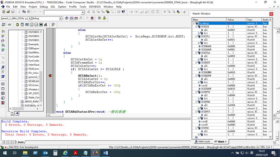

this is the issue of SCI receive. the host which sent data is another MCU, and also checked with PC. The issue is always.
After we initialize the configuration of SCIA after power-on, we will encounter that sometimes the data cannot be received normally. At this time, the data can be received normally after initializing the configuration again. This phenomenon does not occur on every board. Some boards sometimes appear, which is quite confusing.
We check the SciaRegs.SCIFFRX.bit.RXFFST flag at a time of 200us to determine whether there is data to be received.
After the DSP is powered on, the SciaRegs.SCIFFRX.bit.RXFFST is checked in a 200us cycle, sometimes the "if( SciaRegs.SCIFFRX.bit.RXFFST != 0 )" cannot be checked.
here I attached the initialized code.

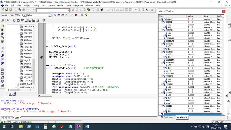

below is the normal condition register status
for abnormal status, the SCIRXST is changed to 0x00B6 or 0x00B2.
Could you kindly review it and give some comments?

  • Hi Emma,
    The first thing to note is the SCIRXST changing to 0x00B6 or 0x00B2. This shows there is a receiver error flag (RXERROR) which is set when any of flags 5-2 of SCIRXST are set. Error is causing because of Break detect (SCI receiver data line (SCIRXD) remains continuously low for at least ten bits), Framing error (an expected stop bit is not found) and parity error (parity mismatch).
    What is the baud rate that is being used? Is the parity check configured on transmit side?
    Check if the GPIO pull up configuration is working correctly on the board.
    It could be due to some external noise. Is the system isolated?
    To recover from receiver error you can use software reset when ever the program detects RXERROR.
    SciaRegs.SCICTL1.bit.SWRESET = 0;
    SciaRegs.SCICTL1.bit.SWRESET = 1;
    Yashwant

    and the odd thing is if they can not receive data in FIFO for 600 times, they re initiation the SCI using the same init function.
    then the issue is clear, so Customer wants to know the root cause.

  • Emma,
                  Clearly, there has been an error. In other words, it is not that the reception has suddenly stopped without any error condition being flagged. Without identifying what caused the error condition, the issue cannot be debugged.
  • Hi Emma,
    Does the customer re-initialize the SCI just once, after which operation continues without errors?
    Also curious to know if the same thing happens when you operate at a lower baud rate, say 9600?
    Note that the occurrence of a break (BRKT) causes a receiver interrupt to be generated if the RX/BK INT ENA bit is a 1, but it does not cause the receiver buffer to be loaded. This could be why you don't see data for 600 times until you perform the initialization again clearing the BRKT bit.
    Instead of waiting for 'SCIAIdleCnt' to equal 600 I would encourage you to monitor the RXERROR bit in the SCIRXST register and if it is set check for the parity error bit (PE), framing error bit (FE), and SCI break-detect bit (BRKT) within the same register. This will help us narrow down what kind of error you are getting and at what time during the communication cycle.
    Marlyn
  • Hareesh,
    Actually, the host MCU will send the data before F28034 finish initiation.
    But at most tests, it will all right.
    does it will cause the SCI receive error?
    BR
    Emma
  • Hi Emma,
    This could be a possible concern. Would you please try adding a delay on the host side so that it does not transmit until the receiving device has had time to finish its initialization?
    Marlyn
