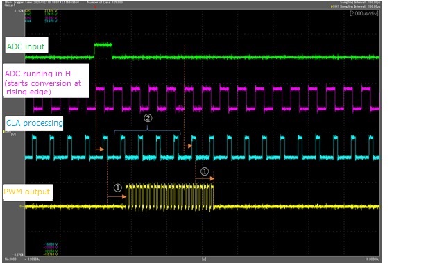

My customer is using TMS320F28379D and having trouble with PWM output.
They are using CLA for updating EPWM_REGS shadow registers, ISR is triggered by ADC conversion complete.
ADC sampling period: 1us
PWM cycle : 0.2us
In the 1st screenshot above, there are 1us latency after CLA processing completion to PWM update (see ①)

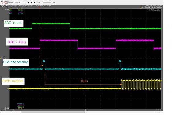

When changing the ADC sampling period from 1us to 10us, the latency ① also becomes 10us. Please see the 2nd screenshot.
How can we reduce the latency?
Also, it looks like CLA processing results in period ② in the 1st screenshot are not reflected to the PWM output.
Are there any limitation?

    Since you mention that the latency increase to 10us when the ADC sampling period changes to 10 us so it clearly suggests that the current sensed value is actually getting processed in the next ISR instead of current one or the PWM period and duty values are getting updated on next events. Did you try using the immediate load option instead of shadowed one for EPWM updates just to debug the root-cause?
    As such there are no limitations in terms of EPWM updates by CLA, you can also look into the latest CLA examples that we provide inside C2000Ware which showcases the sensing and actuation with standalone CLA at a high frequency. Although these examples are for F28004x device but probably could be a good reference for your development

  • Hi Himanshu,
    Thanks to your comments, customer found the rootcause.
    They read ADC value and set to an variable by C28x, and then passed it to CLA.
    That causes the delay and the previous ADC value was used for PWM calculation in CLA.
    After changing the implementation to read ADC register by CLA directly, the latency in ① and ② disappeared.
