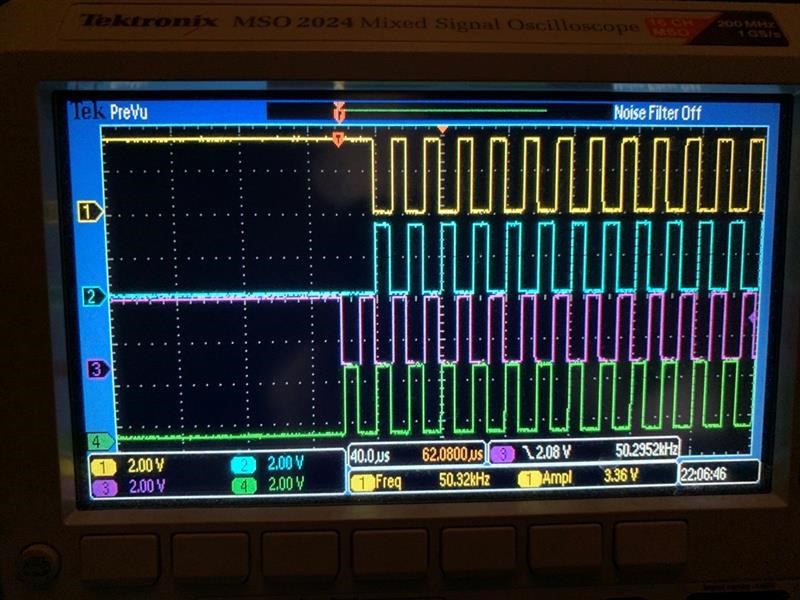

We have included TMS320F28033PAG in our design to control an H bridge (four IGBT:s)
This is a frequency controlled LLC bridge
This is done by using two main output PWMs with one shadow PWM each that runs 180 degrees phase shifted with dead time.
However, we see problem with one of the PWMs (main and shadow) when phase shifting it compared to the other main PWM
Of we have zero on phase shifting at start (TBPHS=0) we see a missing pulse when starting to increase the phase shift to a very small value, see picture below
If we start the pwm set with a very small phase shift (TBPHS = 0.001) at initialization we see the missing pulse directly when the microcontroller starts to generate pulses at the PWMs, see picture below
We do not want to see any missing pulses.

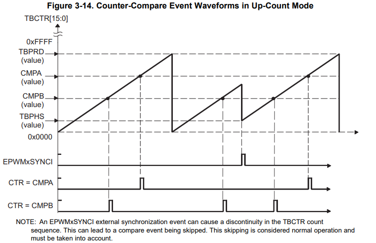

  • Hi John,
    The issue that you are seeing is possibly what is being described in the note for Figure 3-14: Counter-Compare Event Waveforms in Up-Count Mode within the F2803x Technical Reference Manual
    You could try the following:
    1) Move your synchronization point away from your PWM edge.
    2) Use CMPA/CMPB instead of CMPA/ZRO (try setting your CMPx values larger than your max TBPHS value). Refer to  this thread, as it gives a good explanation for a workaround.

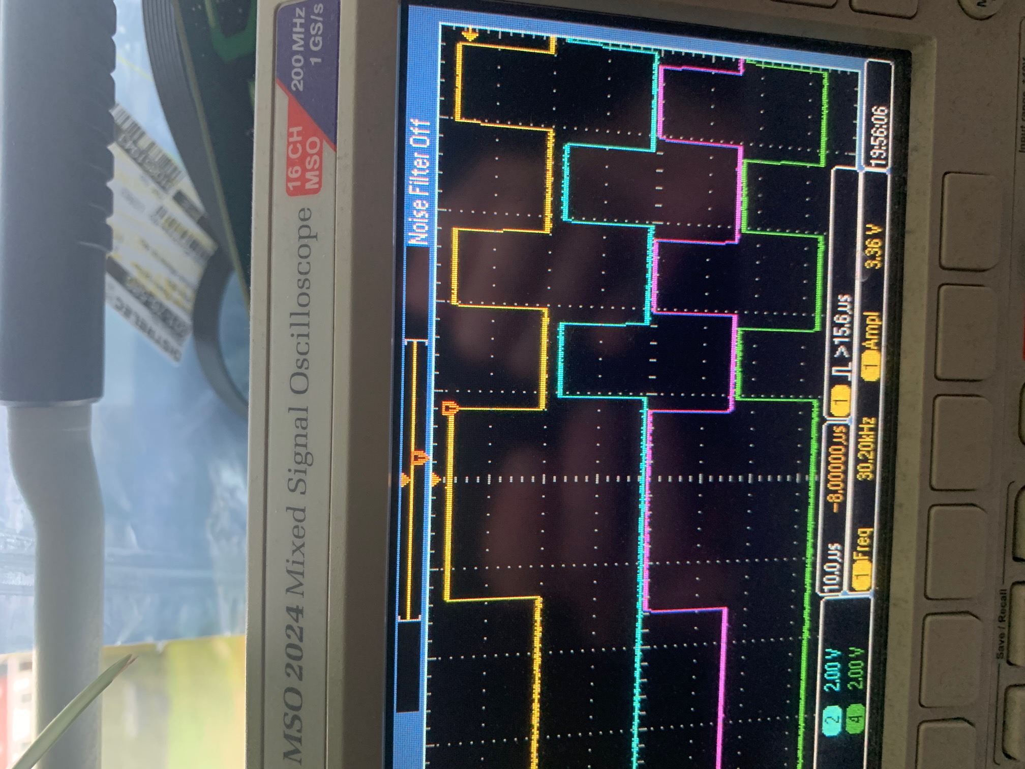

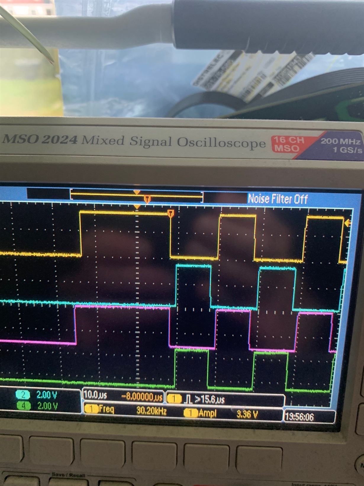

    I did manage to get rid of the missing pulse, but now we see a temporary change in frequency at the same moment.
    See 4 seconds in in the attached movie. The yellow and blue PWM:S shows a change in frequency.
    You can see the softstart feature by following the phase shift in the purple pwm.

  • John,
    One thing that could be happening is that the following piece of code may be executing for the case when phaseShift is equal to 599 considering your MD_DRIVER_PERIOD_CYCLES value is 12000:
    if(phaseShift < (MD_DRIVER_PERIOD_CYCLES / 2))
    phaseShift ++;
    At this point the phaseShift is 600 (599+1)
    Then you set the phase EPwm2Regs.TBPHS.half.TBPHS = phaseShift;
    This may be causing the event on the action qualifier to be missed EPwm2Regs.AQCTLA.bit.CAU = AQ_CLEAR;
    Instead of checking for when the TBCTR counter for EPWM1 is greater than CMPA, try checking if the phaseShift is >= CMPA of EPWM2 in which case you want to set CMPA to be phaseShift +1 just for that cycle so that the event on CAU can occur.
    Was this what you tried earlier when you mentioned "I tried to changed the CMPA value temporary, but it did not resolve the missing pulse"?
    Marlyn

  • One of the most commong causes of a missing pulse, or an AQ action being missed is that when TBPSH is being update, the value is larger than CMPA/CMPB/PRD, and hence the action is skipped. If it is necessary for the action to occur when the CMPx/PRD is skipped, you need to also update the CMPx value to be larger than TBPHS.
    Nima

  • Hi John,
    The code below should check for when "the value is larger than CMPA/CMPB/PRD" in your case.
    if(EPwm2Regs.TBPHS.half.TBPHS >= EPwm2Regs.CMPA.half.CMPA)
    EPwm2Regs.CMPA.half.CMPA = EPwm2Regs.TBPHS.half.TBPHS +1;
    Could you please try putting a breakpoint on this if-statement and check if the condition is ever met? Now, if the code does enter the if-statement then please check the value of CMPA and TBPHS at the time of occurrence, you can set a break-point and read the values from the watch expression window in CCS. Before you leave the function that updates the phase shift value I would suggest to also check the value of CMPA/TBPHS to make sure nothing got overwritten. This last part should be done even in the case that the if statement didn't get executed. This will give us a better understanding of what is happening.
    Marlyn

    I have now the redesign according to your suggestion.
    Now we have two ISRs:
    - one triggered at PWM zero that sets frequency and phase
    - one triggered at PWM midpoint that triggers ADC conversion and calculates new frequency and phase values to be used in the above ISR.
    It seems to be working. We will do some more testing
    However, at boot up and start of the pulses we see a longer pulse, see picture:
    Can we resolve this issue?

  • Hi John,
    I am glad the redesign is working for you!
    The longer pulses at the boot up could be due to the active complementary configuration within your dead-band in the initialization taking effect. One way you could possibly get around this is not muxing the GPIOs for EPWM usage until you reach your very first EPWM zero interrupt (at this point the epwm module should be fully initialized).
    Marlyn
