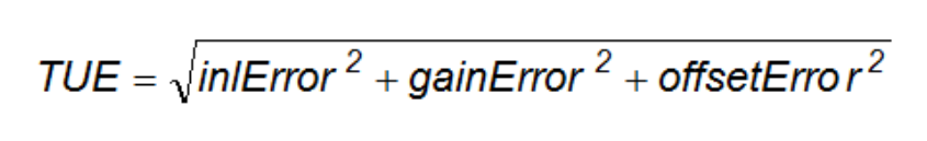

    1. Did they already consider the correct tolerance for CMPSS-DAC?
    [FA] If you are looking at the total error from the CMPSS-DAC, you can use the Root Mean Squared approach. Formula below:
    However, keep in mind that using RSS is a bit pessimistic as you are very unlikely to find a device that has the worst gain error, offset error and inl. Also, INL error already includes DNL error.
    2. How to consider Gain/Offset or all other items from datasheet?
