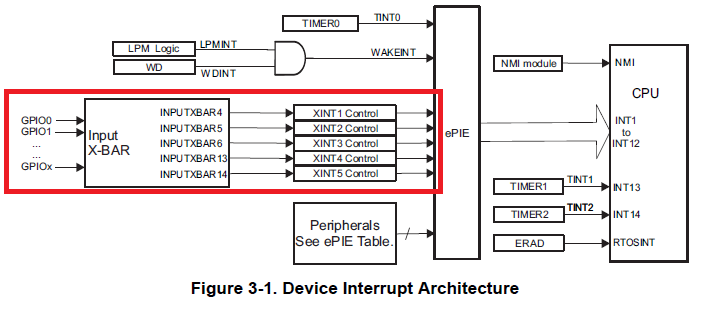

  • Kusti,
    Can I for example use the GPIO pin interrupt facility to get an interrupt when the SPISTE goes down in the slave?
    For example SPISTEB shares pin with GPIO 27 so can I get an interrupt from that pin when SPI is enabled
    You can use Input X-BAR and XINT together to trigger a CPU interrupt when SPISTE pin goes low.
    Manoj
  • Brilliant! We will test this. Perhaps not ideal to waste an GPIO pin on this but we can live with that. Thanks!
