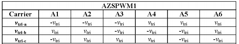

I am trying to implement a PWM method called AZSPWM1 (Active Zero State PWM). In the implementation of this PWM method, I need to assign different values to CMPA and CMPB registers of EPWM in each sector. The required task is shown in the picture attached. I am doing that task in DSP as follows:

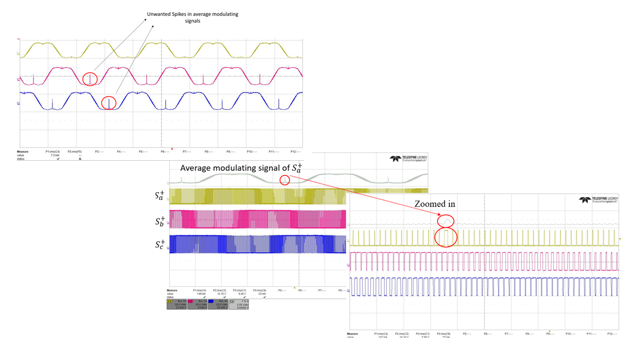

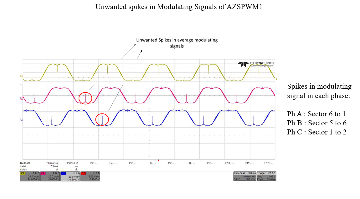

    Picture of unwanted spike is attached.
  • I see. So now the only issue is the larger pulse on the light green/yellow signal?
    Nima
  • No. The issue is with a large pulse in all 3 switching signals. The instant at which it is zoomed in shows the problem with one phase. But if appears in switching pulses of all 3 phases.
  • Can you capture at what value of the CMPA/B that occurs?
  • HQ,
    Can you capture the CMPA/B values when your issue occurs?
    Nima
  • The only way for me to know about the issue is to observe the switching signals and their average. I can not tell the issue by observing CMPA and CMPB values.
  • It looks like it is always happening in the middle of your valley. In blue and pink.
    In yellow its happening in the middle of the peak.
    What are the values of your CMPA/B in those ranges?

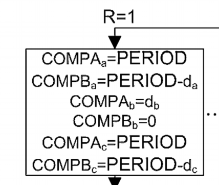

  • The CMPA and CMPB values are based on whether triangle carrier reversal is required for a given phase in a given sector which is shown in the image below. For example, in Sector 1, reverse polarity of triangular carrier is required for Phase A (EPWM 7) and C (EPWM 9) (which is achieved using CMPB) and no reversal of triangular carrier is required for Phase B (EPWM 8 which is achieved using CMPA). So, in sector 1, CMPA and CMPB will be set as follows:

    Based on these variations in CMPA and CMPB values in each sector, I am not sure if I can capture the exact value of CMPA and CMPB at the moment of spikes.
  • HQ, the EPWM setting code you are sending is correct. I do not see any issues with the action qualifier module, Is the EPWM supposed to have 100% or 0% duty at the time the spikes occur?
