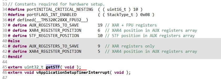

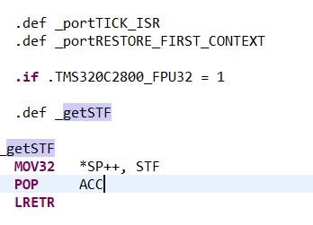

I have a TMS320F28388D and docking station and attempting to blink an led using the FreeRTOS code here https://github.com/IvanZuy/freertos_c28x and modifying to suite my MCU. I am running into the error below and wondering if my assembler function definiton is correct as I beleive it is giving me issues. Can someone verify? The first picture is the function defintion in the .asm file and the other is the extern declaration in my port.c file.
portasm.asm(Another question, what does it meaning when "getSTF" is highlighted as a light blue color? I know the grey highlight signifies code that isn`t run):
port.c file:
Error I get:
I have also included the two files below:
portasm.asm

#if defined(__TMS320C28XX_FPU32__)
# define AUX_REGISTERS_TO_SAVE        19 // XAR + FPU registers
# define XAR4_REGISTER_POSITION       6  // XAR4 position in AUX registers array
# define STF_REGISTER_POSITION        10 // STF position in AUX registers array
#else
# define AUX_REGISTERS_TO_SAVE        9  // XAR registers only
# define XAR4_REGISTER_POSITION       5  // XAR4 position in AUX registers array
#endif
extern uint32_t getSTF( void );
