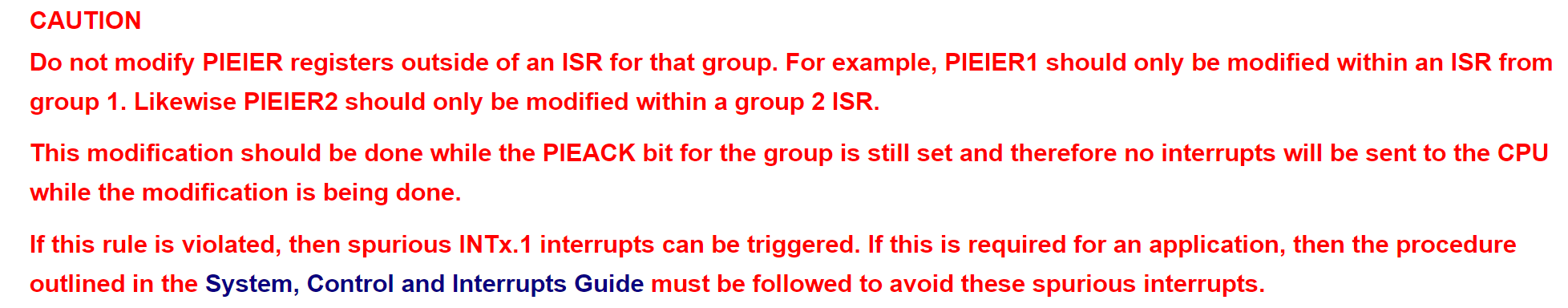

We see below warning in link below:
I am not sure if this has been discussed before, could you provide more information to help me understand it?
Sheldon
processors.wiki.ti.com/.../Interrupt_Nesting_on_C28x
  • Sheldon,
    We have a nested interrupt example in C2000ware:
    [c2000ware_install_Dir]/driverlib\f28004x\examples\interrupt\sw_prioritized_interrupts
    The example demonstrates how to nest more than one level. In each interrupt higher priority interrupts are re-enabled allowing them to nest deeper than one level.
