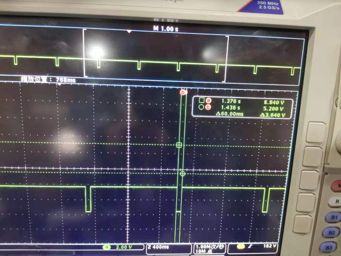

my customer tries to wake up F28069 from HALT mode through a GPIO, and the pulse on the GPIO port is as below:
 low pulse is 60ms, and according to the datasheet HALT Mode Timing Requirements
tw(WAKE-GPIO) need to be at least: toscst + 2tc(OSCCLK), toscst=10ms(typical), external clock is 20MHz, which means tc(oscclk)=0.05ms.
So 60ms is way longer than needed.
But we find that we can not always wake up the device, the success rate is only 30%.
Could you please tell me what's wrong here?

    Where does the wakeup signal come from? If it is coming from another board, are the two grounds connected together? Could you please try C:\ti\c2000\C2000Ware_3_03_00_00\device_support\f2806x\examples\c28\lpm_haltwake ?

    That is a tested code. Not sure why it is not working in your setup. I presume the scope waveform was captured at the GPIO pin of 28069. It is hard to debug issues like this without access to the hardware. Is the behavior the same no matter how many time you try?

    sorry for interrupt. I test this code on our EVM.
    The problem is caused by the GPIO0 is not high-low-high, but high-low-floating.
    I tried GPIO0 high-low-high, and it works well.
    I'll let the customer test our code on their board to see if this code works.
