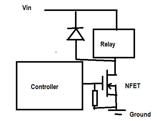

I want to drive a relay (needs around 20mA for the control input) with a GPIO of the microcontroller. Except a transistor or an optocoupler, is there a circuit I can put between my microcontroller and the relay to increase the current to drive the relay ?

    20mA load is too small for our motor driver products. I would think a small transistor could work.
    What is the initial status of that relay, or the power up sequence? If the mircrocontroller and GPIO was powered up, but, relay circuit has been powered up, do you want to see the 20mA or 0mA? You can put a NFET or a PFET switch between the relay and the ground to control the relay; and put a 100kohm resistor between the FET's gate to ground. The FET gate is controlled by the mircrocontroller GPIO. A NFET or PFET is related to the initial status setting.
  • Hi Wang5577,
    When everything will be powered up, I want to see 0mA on the relay, so do I need to put a NFET or a PFET ? Do you have a product example ?
    For my application, is it better to use a JFET or MOSFET ?

    To clarify my first post's idea, I just draw the circuit.
    BTW, you can use a resistor divider to convert a digital signal 0-5V to a 0-3,3V.

  • Hi Wang,
    The relay needs around 15mA for 5V or 20mA for 3,3V.
    Please find the wiring diagram :
    Do I need to use a flyback diode between pins 3 and 4 ?
    I want to use one of your transistor, that's why I asked you for a component reference.
    Is the scheme correct ?

    We are on the same page. What is the relay device part number? Would you post a question on that device about how to drive it?
  • The relay is not a Texas device, but it's not very important.
    I just want to have a (Texas) transistor part number which can drive 15mA for 5V or 20mA for 3,3V with a Vgs = 3,3V
    I found a lot of NFET but I think they are not appropriate with my application, because I don't need a power transistor.

  • Hi electrocc,
    You may be able to use the SN74LVC1G07 device for this. It can sink up to 24 mA when supplied with 3.3 V.
