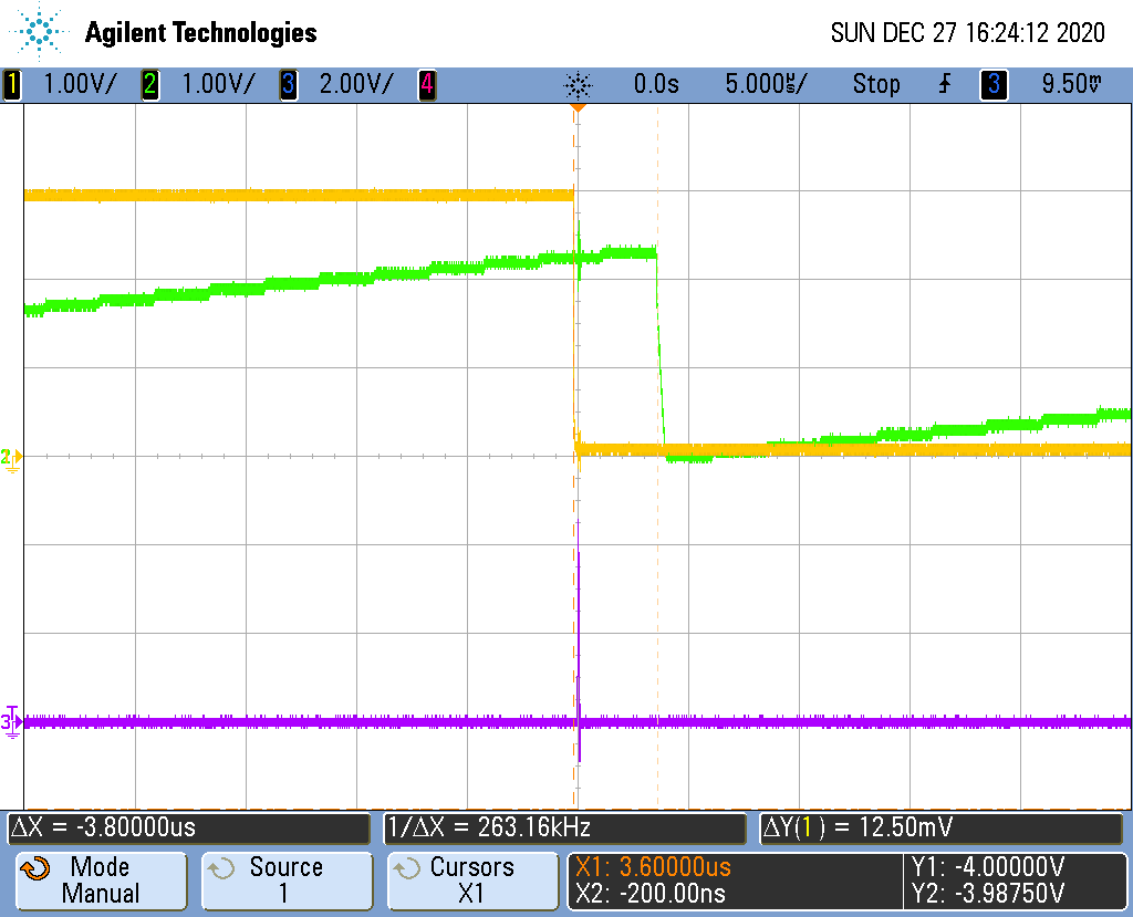

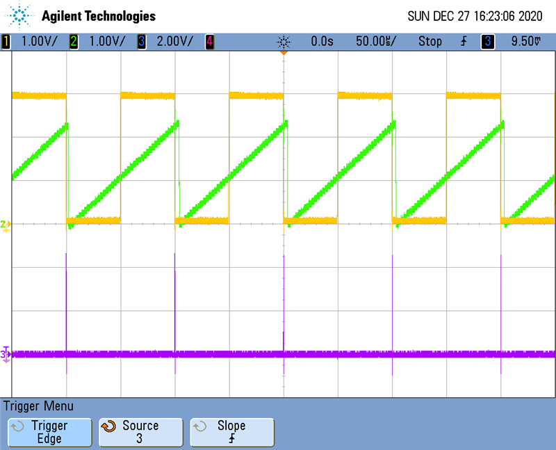

I use the Ecap1 module with LaunchPad 28379d to measure the pulse wave's duty cycle.
My setting :Cap1 detect rising edge and TSCTR is not count to zero
Cap2 detect falling edge and when Cap2 detect falling edge.The TSCTR is clear and go to interrupt to read value
As picture show in below.Yellow is input signal(10kHz ) to gpio24. Purple is interrupt signal. And green is TSCTR which using DAC function to observe.
My question is  why TSCTR need to take around 3.8us to be set zero????

    I looked into the above waveforms and have below couple of questions to root cause the issue:
    • Are you able to read the ON time ticks correctly? The difference between Falling edge and Rising edge reading corresponds to 50us?
    • Since you are using DAC in background loop to generate output waveform correspond to TSCTR so maybe the observed delay corresponds to time of completion of ISR to DAC complete conversion. Have you checked the time spent inside ISR?
    If my reply answers your question please click on "This resolved my issue" button located at the bottom of my post.
    Himanshu
  • Hi Himanshu
    Thanks for your reply~~
    When enter ISR ,the purple wave will be set to high level,and when finish ISR processing ,the  purple wave will be set to LOW,
    So,I think it is not cause by ISR time.
    And how can I check my  DAC complete conversion time?
    thanks~~
      YES!! I see the result when rising edge,my capture value is 10000.  when falling edge,my capture value is 20000. I  think it's correct.
    As you replied "YES!! I see the result when rising edge,my capture value is 10000.  when falling edge,my capture value is 20000. I  think it's correct"
    - So what exactly is the issue if you are able to measure the duty/width correctly? Regarding the TSCTR->0 latency mentioned by you above, as I said it might be mainly because of the interrupt completion and DAC conversion latency. You can profile the ISR and DAC conversion routine by using profiling GPIOs or CCS debugger clock. You should be able to find a lot of resources on web guiding you with profiling using CCS.
