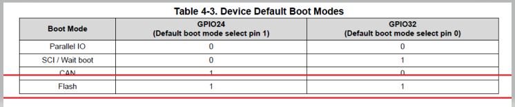

     I select the Flash_Lib configuration, load the flash and set the boot switches on LAUNCHXL as GPIO24=ON (ie zero) GPIO 34=OFF (ie one) which I think is boot from flash.
    You need to drive both BOOTMODE pins ((GPIO24 and GPIO32) high to select the flash boot. See the below table from TRM -

  • Hi, thanks for answering.
    My bad, I miswrote, I did mean and tried the hi,hi  combo (all the other seven combos you can create with two bits ;) .
    So that as such is not the problem. The question really is how to debug this?

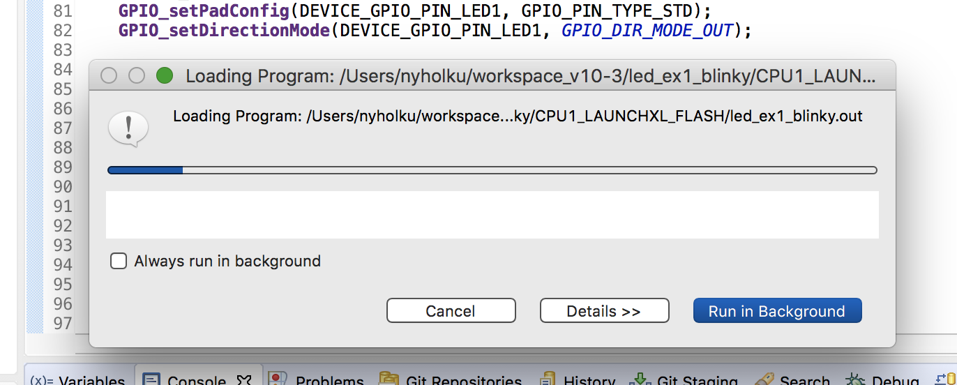

    I went through the list and did no spot anything.
    So I went back to basics and thought I'd try something ready made that should run out-of-the-box.
    I imported
    ti/c2000/C2000Ware_MotorControl_SDK_3_00_01_00/c2000ware/device_support/f28004x/examples/led/CCS/led_ex1_blinky.projectspec
    and apart from the fact that CCS selects wrong launch configuration it runs under debugger no problem and blinks the led.
    However I can NOT make it to run standalone.
    Below some screen shots.
    This must be something totally trivial and I will feel silly when it is solved.
    Regardless, thanks for the great support and have a Happy and Properous New Year 2021.
