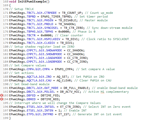

Could you help solve the following error:  error #515: a value of type "int" cannot be assigned to an entity of type "union DBFED_REG"?
