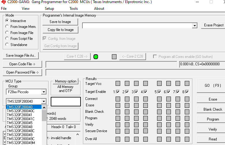

Hi team,
My customer has C2000-GANG and they want to know if it can be used to program TMS320F280049. In C2000-GANG product page it did not mention that. If not supported, please advice alternatives for massive production programming. Thank you!!
Jo
  • Jo,
    I can confirm the that the F280049 device(and all F28004x devices) are supported by the C2000-GANG.  Customer can find these devices under the F28xx Piccolo Group. I'll work to get the web page updated to reflect this.  Below is a screen cap to share as well:
    Matthew
