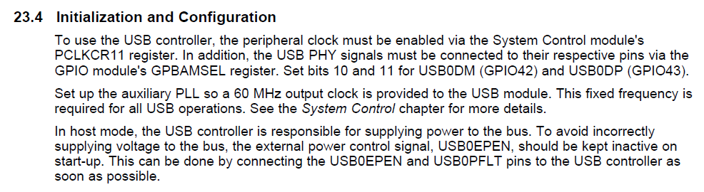

  • Hi Merril,
    I believe the USB module has internal pulls to meet the spec requirements. The USB section of the TRM mentions the transaction process being automatically handled quite a bit, like below:
    I'm going to confirm with the team and get back to you.
    Kevin
  • Hi Merril,
    Confirmed with the team, external pulls are not needed on your board. The C2000 USB module takes care of the pull requirements documented in the USB 2.0 spec.
    Kevin
