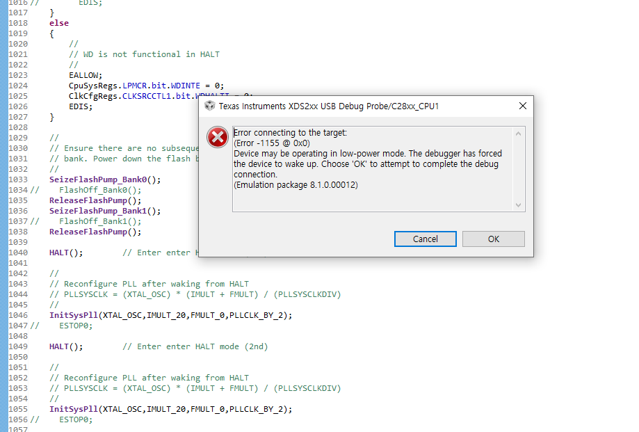

        HALT();        // Enter enter HALT mode (1st)
    // Reconfigure PLL after waking from HALT
    // PLLSYSCLK = (XTAL_OSC) * (IMULT + FMULT) / (PLLSYSCLKDIV)
    InitSysPll (XTAL_OSC, IMULT_20, FMULT_0, PLLCLK_BY_2);
    // ESTOP0;
        HALT();        // Enter enter HALT mode (2nd)추가

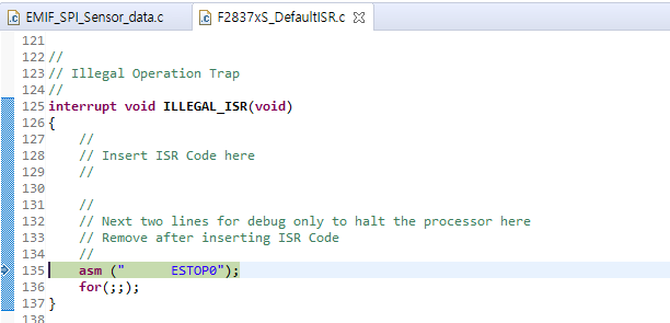

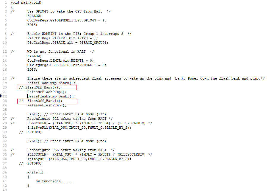

    Can I ask additional questions?
    1. An error occurs when executing number 1 and  number 2.(see above)
       - Can you tell the cause? (It jumps to the ILLEGAL_ISR() function.)
     . // FlashOff_Bank0 (); // number 1 // Do not run
      // FlashOff_Bank1 (); // number2 // Do not run
    2.  HALT mode works well.
        - But, There are times when a program can be injected and there are times when it doesn't.. (see below)
    3.  Should I always reconfig after entering halt mode (after wake up)?(see above)
        - Before, only one function was called.(HALT();l)

  • Any function that powers down the flash must be copied to RAM and executed from there. Are you doing this? Code that powers down the flash cannot be executed out of flash.
  • Kang Youk,
    Are these flashoff functions mapped to .TI.ramfunc in your code?  If yes, in your linker cmd file, where is .Ti.ramfunc mapped to?
    ITRAP occurrence tells that the function is not executed correctly - Need to check whether the memcpy is called correctly to copy from flash to RAM or not.

  • I was mistaken.
    The program runs in Flash, not RAM.
    I will think a little more.
    Question 2 is not resolved.(see above)
    Should I perform the same procedure every time when entering HALT mode?
    (The main function procedure and timer2 interrupt function procedure are the same.)
    I will close the thread after this question.
    Thank you.
  • Kang,
    As clarified by both me and Vamsi, any function that shuts down the flash must be copied to RAM and then executed from there. I have attached a sample code, that clearly shows how to do this. This was written for a different device, but the idea is the same.
