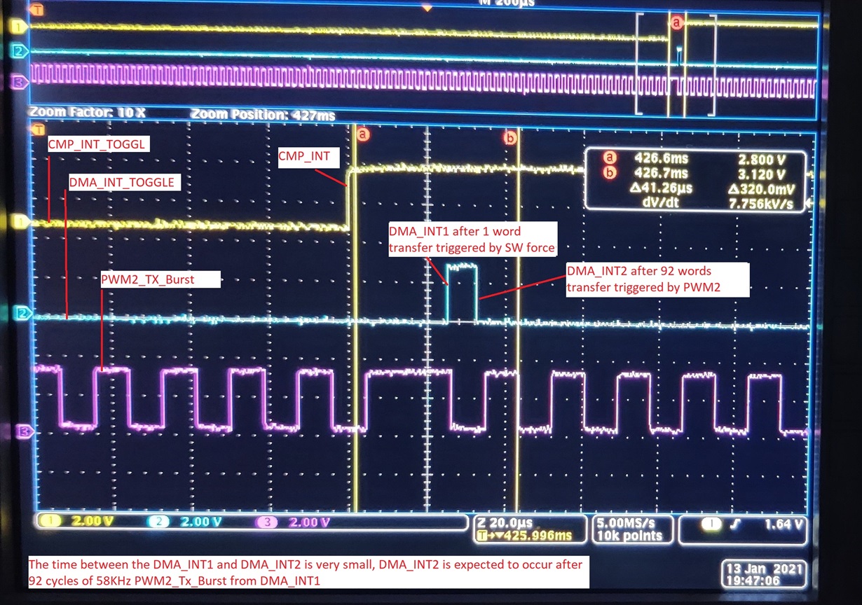

HI Team,
We are using the DMA to generate the required number of PWM cycles and have issue with ONESHOT, When ONESHOT  is disabled its not waiting for the event so unable to count the number of PWM cycles.
  1. We need to start the PWM on the ECAP interrupt, As ECAP cannot trigger the DMA, First we are triggering DMA with Software force bit is set (DmaRegs.CH1.CONTROL.bit.PERINTFRC = 1).
  • Here only one word (1 Burst of length 1 word ) will be transferred.
  • DMA transfer is completed and DMA interrupt is generated as shown in the diagram below. (DMA interrupt is generated at the end of the transfer).

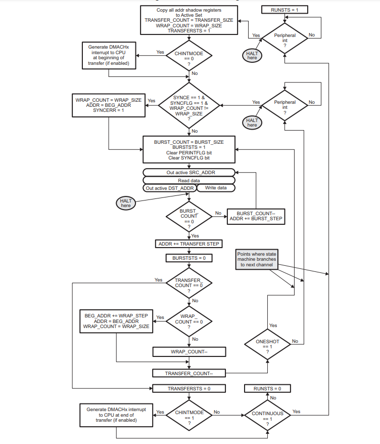

  1. In the DMA_ISR, Initialize the DMA to trigger from the EPWM2SOCA on every CTR = PRD and start the transfer for 92 word (Burst length is 1 word, Total 92 transfer).
  • The ONESHOT bit (DmaRegs.CH1.MODE.bit.ONESHOT = 0) is not set so DMA should wait for Peripheral trigger (From PWM2 ADCSOC when CTR = PRD) after each transfer.
As you see in the diagram, After first DMA Interrupt(DMA_INT1) one word is getting transferred and after 2nd interrupt (DMA_INT2) remaining 92 words are transferred but the transfer is not happening on every PWM cycle, All 92 words are transferred on single PWM event, Seems it’s not waiting for trigger after each transfer.
Please let me know if you need more details, Please test ONESHOT bit at your end and confirm.

  • Ajay,
    I'm going to attach a picture of Figure 11-5 on page 730 of the F2806xTRM, which is the state machine of the DMA.  It will go along with my explanation and hopefully help resolve your issue.
    Let me elaborate on the CONTINOUS bit and ONESHOT bits:
    CONTINOUS bit: will keep the DMA enabled/active after the first complete burst, without the need for the CPU to set it again, either in an ISR or otherwise.  If it is not set then after each burst(until a transfer is completed) the RUNSTS bit for the respective DMA channel would need to be set.  Since the DMAISR will not fire until the full transfer is complete; you will need to keep this bit set as you have observed.  An alternative would be to use a different ISR, if you were using the eCAP or ePWM ISR to set the RUNSTS, assuming each of these ISRs would occur before the next period/DMA trigger.  For overhead reasons CONTINOUS bit = 1 makes sense to me in this case.
    ONESHOT bit: This will immediately fire a BURST until TRANSFERCNT = 0 on just one trigger to the DMA, which is what you observed originally.  In your system this is not the effect you want, i.e. you want each burst to wait for the signal from the ePWMSOCA.  In the absence of the CONTINOUS bit this was allowing you to complete the transfer though.
    For the ISR question; looking at the code you have provided this should be sufficient to enable both the global group(IER = 7) that all the DMAISR belong to as well as the local DINTCH1(INT7.1) in the PIE.  You should see 2 triggers of the DINTCH1 ISR, after your initial DMA force(since transfer count is = 0) and again after the 92 triggers/bursts have happened when the ePWMSOCA is the trigger.
    When we enter any ISR all other Interrupts are disabled via an automatic action of setting the INTM(interrupt mask bit) bit globally as well as clearing the IER bit.  These will get restored when we exit the ISR.  I think in this regard the eCAP ISR may be interfering with what we want the DMAINT to do, you would need to manually re-enable the IER = 7 globally inside that ISR as well as clear the INTM bit so that we can service the DINTCH1 ISR.  I also think we need to add a PIEACK for the eCAP group.
    Let me know if this works.
