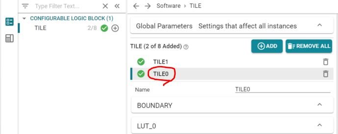

CLB TILE numbers range from 1 to 8 in RTM. But TILE0 is generated from CLB Tools as the attached figure.
Would you please clarify what is correct?
Steve
  • I figured out the TILE number generated from CLB tools is just a name that can be modified by the user. This name affects the function name in the generated file. However, it would be nice if the default name matched RTM.
    -Steve
