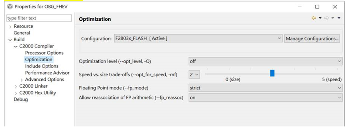

The user uses compiler V15.12.6.LTS as follows.
The optimization was OFF as below.
