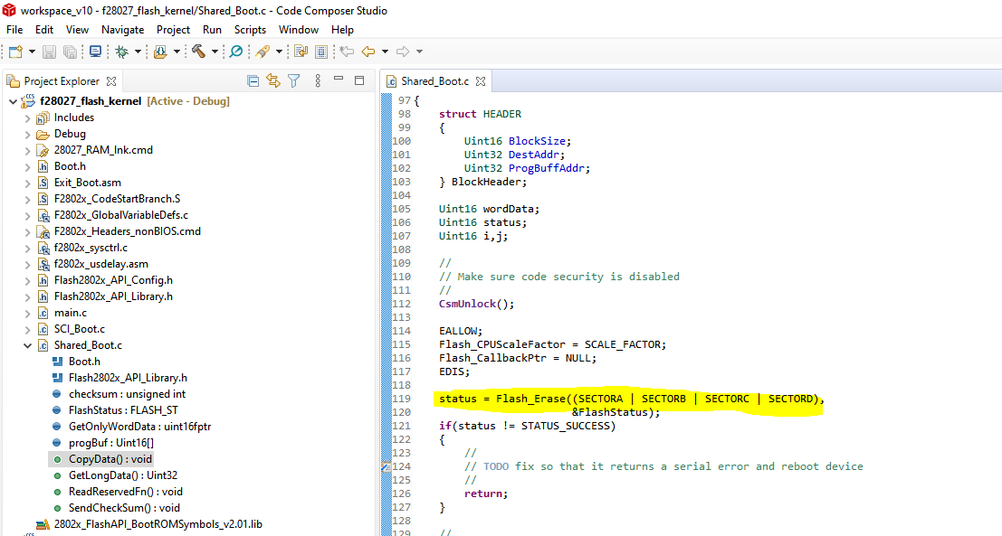

TMS320F28027: In out implementation F28027 uses kernel A for programming, It programs all 4 FLASH segments: A, B, C, D. I would like to program only FLASH segment C. How to do it?
Part Number: TMS320F28027
In our F28027 uses kernel A for programming, It programs all 4 FLASH segments: A, B, C, D. I would like to program only FLASH segment C. How to do it?
The documentation mentiones that the kernel A is for TMS320F28027, but it does program all segments together.
Kernel B, accoridng to documentation, can program FLASH segment individually, but it seems that it cannot be used with TMS320F28027.
This has to be done in the field, without JTAG, from another processor, and it already wors for all four segments.
It seems to be feasable, since the TI UniFlash tool can program individual FLASH segments, A, B, C, D.
Please, advise me how to field-program TMS320F28027 FLASH, only segment C, or only segments A, B,  D with the flash kernel of TI without JTAG.
