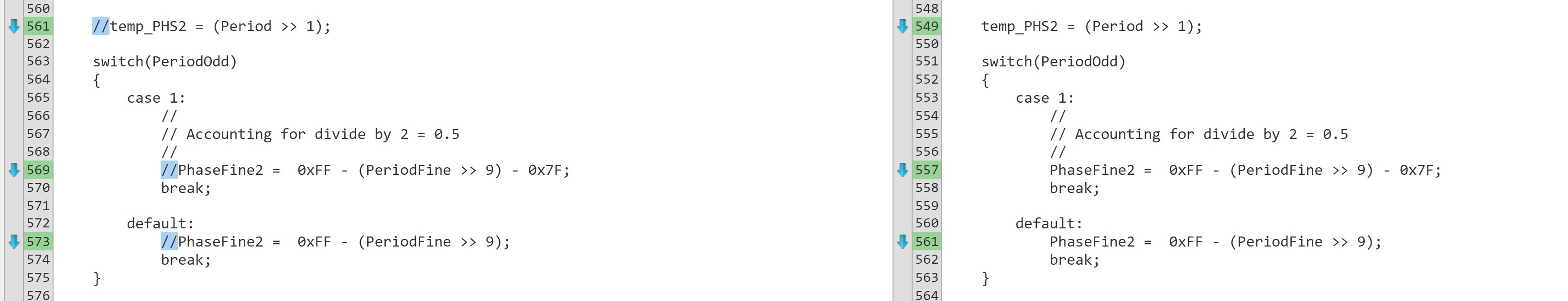

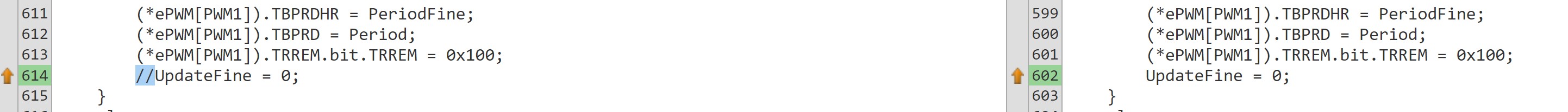

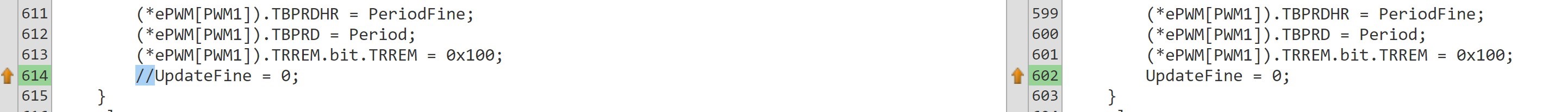

    I tried to make a simple code based on the example by commenting out the calculations and writing the value directly to TBPRDHR, TBPRD, TBPHS, TRREM.
    For the result, the jitter still appears when writing a little large value to the TBPRDHR.
    If setting zero to TBPRDHR, the jitter will disappears.
    I am attaching the C source, could you confirm and give me any comment on this issue?
    Should I write zero to TBPRDHR, when enabling phase load (TRREM) on SYNC?
    Thank you.
    Wenjing

        //temp_PHS2 = (Period >> 1);
        switch(PeriodOdd)
            case 1:
                // Accounting for divide by 2 = 0.5
                //PhaseFine2 =  0xFF - (PeriodFine >> 9) - 0x7F;
                break;
            default:
                //PhaseFine2 =  0xFF - (PeriodFine >> 9);
                break;
        // No fractional phase shift to account for
        temp_REM2 =  (Uint16) 0x100 + PhaseFine2;

            (*ePWM[PWM2]).TBPRDHR = PeriodFine;
            (*ePWM[PWM2]).TBPRD = Period;
            (*ePWM[PWM1]).TBPRDHR = PeriodFine;
            (*ePWM[PWM1]).TBPRD = Period;
            (*ePWM[PWM1]).TRREM.bit.TRREM = 0x100;
            //UpdateFine = 0;

  • These lines of code are necessary. Using HRPWM in both phase and period mode REQUIRES to follow this specific instructions.
    If you don't, you will get issues with jitters. In general if one of the HRPRD or HRPHS requirement can be removed, go ahead and just use one of the mode.
    This ensure that updateFine is set and used when necessary.
