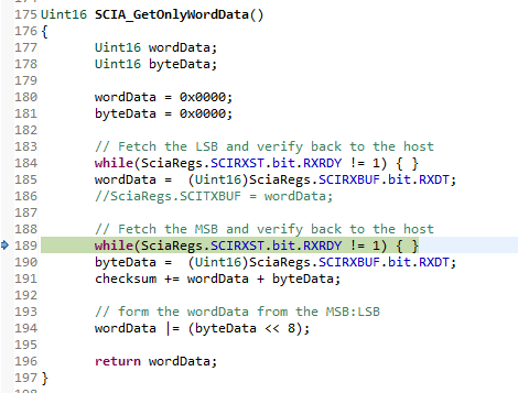

  • If you download the kernel through JTAG, and you halt the code, can you check where execution is at? Is it where it needs to be? I can take a look at the kernel code tomorrow to give you a better idea.
    Sira
  • Program stops here
  • This is quite puzzling, I don't know why this is happening. In debug mode, when you download the Flash kernel via JTAG, what hardware mode is the board set to? I am not sure if it matters or not, but it would be good to know - maybe switch it and see if it makes a difference.
    Sira
  • I used the F boot mode. The E boot mode work without downloading the Flash kernel via JTAG.
  • I am consulting with team members, I'll get back to you.

  • I cant insert here .map file. Link to the gdrive with .map file  drive.google.com/.../view
  • Are you using the F28335 ControlCARD? Can you send me a picture of your setup - I want to see how you are connecting the Serial cable.
    In the case where you are downloading kernel using CCS/JTAG, you have both the JTAG cable as well as the serial cable connected?
