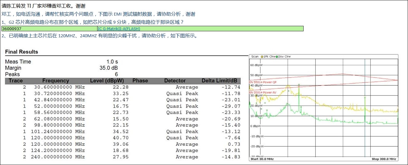

My customer board base on F28035 report the Radiated EMI over spec on 120Mhz & 240Mhz. Below is the test data for reference.
Customer detect the most radiating noise close at pin70 VDDIO by using near field probes. However each Vddio/Vcc pin already connected 2.2uf and 0.1uf cap close to the pin which should meet datasheet requirement.
We suspect the issue caused by F28035 internal PLL circuit because we config the device CLOCK as 60Mhz. Customer would like to know the internal PLL circuit is placed close to which pin of F28035? So that they can try layout the wire far way the PLL circuit.
    What is the PLL output? Is it 120 MHz that is subsequently divided by 2 to produce 60 MHz? If so, can you try 60 MHz output?
    The PLL is close to X1/X2 pins, so not near pin 70. Pin 36 is also VDDIO. Is emissions excessive near that pin also?
