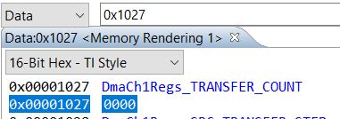

I met a problem when I was testing the example projects "adc_ex6_soc_continuous_dma".
The technical reference manual says the parameter in the register TRANSFER_COUNT will be 0 when the dma channel fishes the transfer, and I insert one line code in the dmach1ISR just as below,
but the variable reads as 63,not 0, and I read this register in the memory browser, it is read as 0.
I am confused how this happen? what is the problem?
look forward to your reply.
  • Wang,
    TRANSFER_COUNT register is 16 bit register. You are using HWREG macro  which is used to references a unsigned 32 bit integer as shown below. You should instead use HWREGH macro to reference to 16 bit unsigned integer. Once you do that you should get the correct TRANSFER_COUNT value.
    //Defined in hw_types.h
    #define HWREG(x)                                                              \
            (*((volatile uint32_t *)((uintptr_t)(x))))
    HWREGH macro references a unsigned 16 bit integer as shown below.
    #define HWREGH(x)                                                             \
            (*((volatile uint16_t *)((uintptr_t)(x))))
