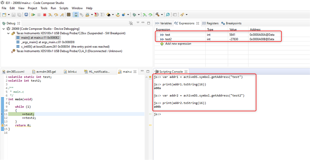

  • I tried the example main.c without issue.
    When at main, enter the below command in the scripting console:
    js:> activeDS.symbol.getAddress("test2")
    It should return the address (as an integer value). Does that work? If so, then it may be an issue with your script

  • Stuart Baker said:
    You will see in my main.c example, "test2" is NOT static. Paul is not having an issue with non-static globals. He is however having a problem with static globals, in this case, from my example, a variable called "test".
    I do not have an issue with either test or test2:

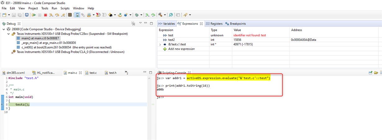

  • Ki,
    I moved the static variable into its own compilation unit. I can reproduce the issue (static variable out of scope).

  • Yes that would be expected since 'test' is out of scope. If Paul is trying to access the variable "as-is" while the variable is out of scope, that would explain the script failure.
  • Ki,
    I agree. In the watch expression window, we can use the '<filename>'::<variable name> syntax to "scope" the access of static variables. Can we do something similar in the scripting console to give it the scope necessary to find the static variable?
    Stuart
  • Not with symbol.getAddress API. But as a workaround you can use a GEL expression with the expression.evaluate API:
    js:> var addr1 = activeDS.expression.evaluate("&'test.c'::test")
  • Ki,
    This is interesting. It does seem to work for me. Paul, can you evaluate this on your end to see if it meets your need?
    Stuart

  • Sweet. That worked. Thanks.
    So do not try "getAddress" with static variables is the lesson ?

        var max_num_fault_entries_addr = debugSession.expression.evaluate("&'lcd.c'::max_num_fault_entries")
    I looked in DSS_API documentation but could not find this detail.
    I would need to confirm this but it appears that getAddress would require the variable to be in scope.
    expression.evaluate allows you to use GEL to workaround this limitation.
    It would not be in the DSS API documentation since expression.evaluate is simply a way to call GEL expressions. You can reference the GEL documentation in the CCS User's Guide:
    https://software-dl.ti.com/ccs/esd/documents/users_guide/gel/namespace.html#gel-namespace
