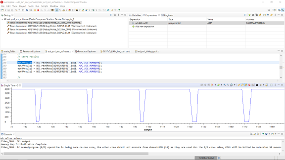

i tried to supply the board with an external voltage generator. But the adc values are not as expected.
First i tried the "adc_ex1_soc_software" example for testing with power supply from USB (no external source). I connected the generators ground to the ground above Pin 23. The signal of the generator to PIN 30. I watched the adcAResult0 in CCS with the "Graph" tool while i used a sinusoidal function (1Vpp with 500mV offset -> 0V to 1V ).
It works - see picture 1. (I'm just wondering that the voltage seen by the controller is below zero - with an osziloskop it is exactly 0 to 1 V..maybe someone can help me with that too?)

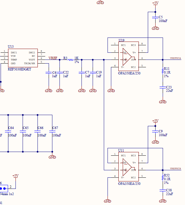

    >You can also probe the VREFHI signals to inspect the full-scale voltage provided to the ADC for better context.
    Yes i thats what i would like to do - can you explain how to probe the VREFHI voltage? I thought, that VREFHI is the same voltage that i can measure on Pin 1 - the 3.3V Pin. I can measure a voltage of 3.232V via USB supply (measured with a fluke multimeter). Thats seems a little bit arbitrary ? Is that the value of VREFHI ?
    You can see the schematic for potential components and points to probe.  R3, R11, and R52 would be good candidates:
    No, you can see in the schematic that VREFHI is independently generated using a high-precision REF5x device and buffered using op-amps.
    You can find information about how VREFHI contributes to expected ADC conversions in the TRM.
