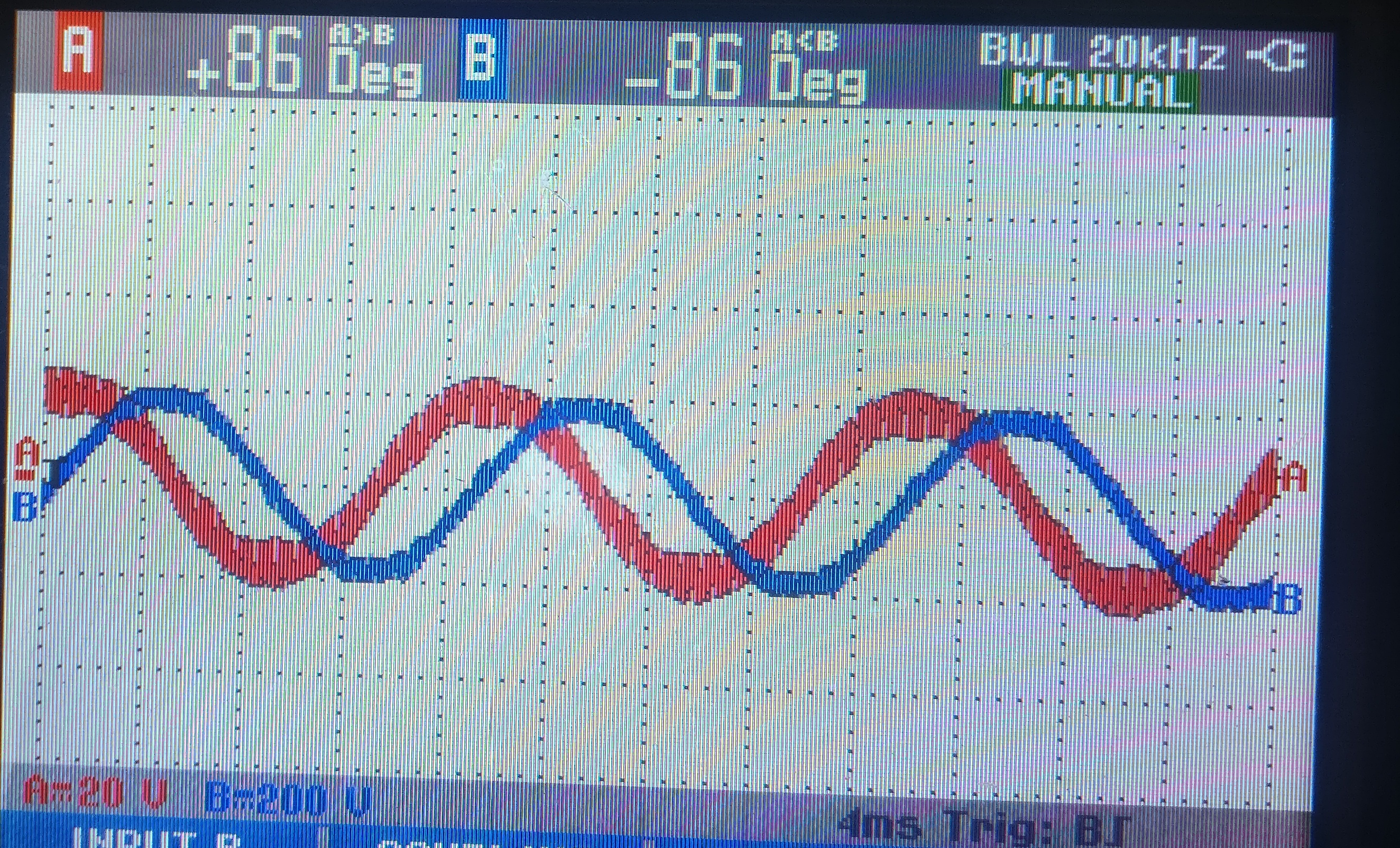

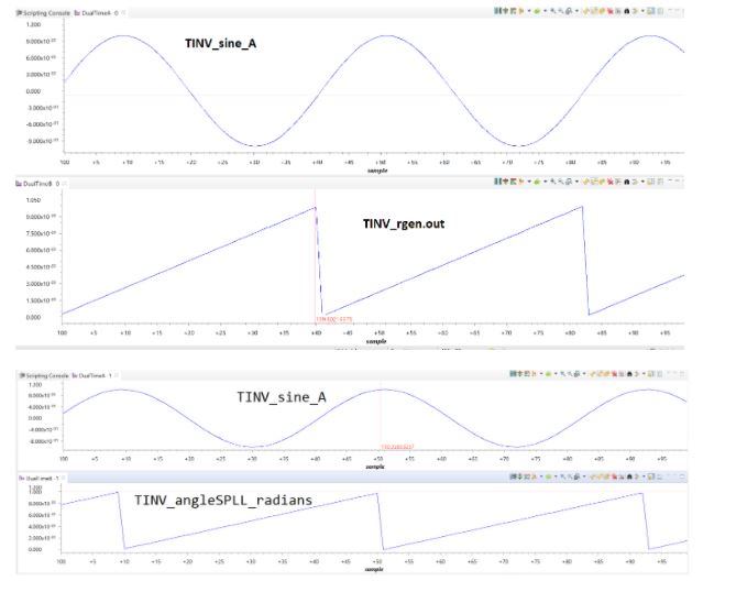

I am using the DDSRF pll function to estimate grid angle and use that theta subsequently in the generation of my inverter's three phase output. The frequency of my three phase output is matched with that of the grid frequenxy(60 Hz). But there is a phase lag of 40deg between the grid three phase output and the three phase output of my prototype. Can this phase margin be fixed by tuning the damping factor specified in the spll_coeff_compute.pdf in solar/v1.2 directory? Any ideas or advice is greatly appreciated.
Srini
