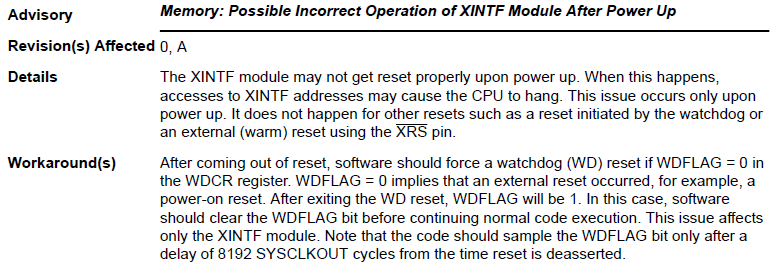

Part Number: TMS320F28335
Is it possible for the cpu to hang on power up regardless of the code being loaded?
The problem is not because of what's in or not in the code?
