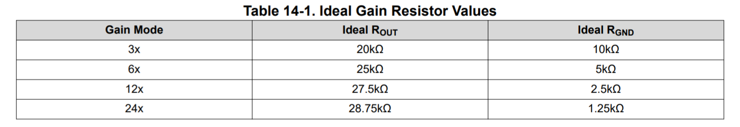

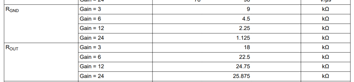

My customer wants to use internal PGA to save cost.
but they found the resistor is different in Datasheet and TRM.
should you double check which is exact?
and could you tell me where to find the resolution of the resistor?
