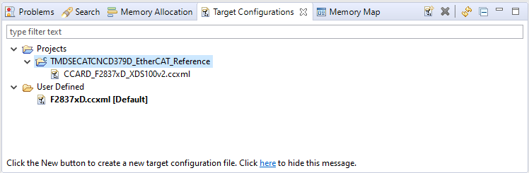

    There were two target configuration in the project :
    • When I use CCARD_F2837xD_XDS100v2.ccxml, I cannot connect to the MCU ; this is the report error :

    • When I use F2837xD.ccxml, I can connect to the MCU
    I will create a new topic, thank you.
  • That is very strange. I would have expected the CCARD_F2837xD_XDS100v2.ccxml to work given that the control card you are using has an embedded XDS100v2 on it. If you require further assistance please post a screenshot of both target configs for comparison.
  • It's very strange, I compared both configurations, there're identical.
