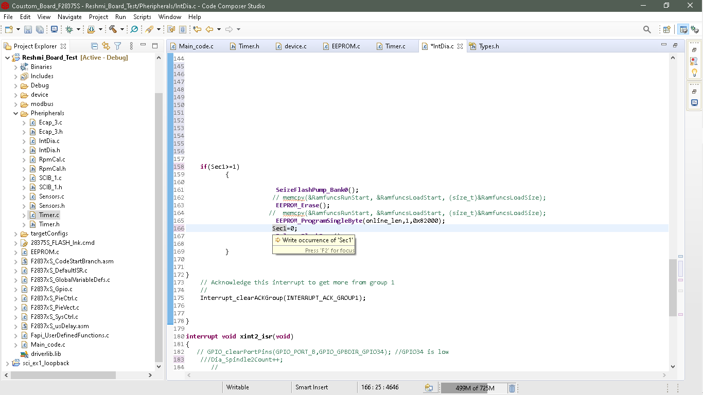

   I am using  TMS320F28375S-Custom board , in my application every one second once i am erasing and writing on flash sector B at location 0x82000.When i am work with same code on TMS320F28379D works well. Now i am facing the problem as after few second debugging gets off...it return a page as given bellow .
After force running getting again debug error as
After executing the EEPROM Erase function debug gets stop ,oReturnCheck  return as  Fapi_Status_Success.
This my code for erasing :

Writing Evey one sec once:
 if(Sec1>=1)
                         SeizeFlashPump_Bank0();
                         EEPROM_Erase();
                         EEPROM_ProgramSingleByte(online,1,0x82000);
                          Sec1=0;
                         ReleaseFlashPump();

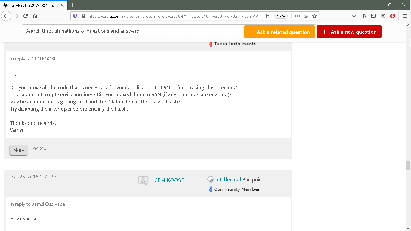

When i am go through your previous post find an related problem , in my code interrupts(External INT, SCI, Timer) are works
behind .
Checked adding DINT,memcopy function before the erasing statement , but it doesnt work ..getting stop...

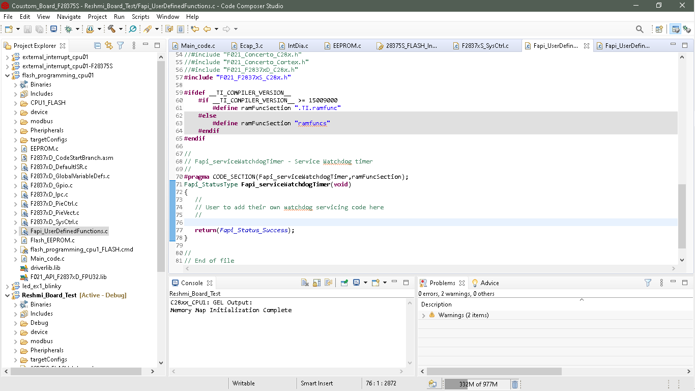

Fapi_userdefineFunctions.c file

1.Which one is Copy API function?(move to RAM)
2.Where i have to add?
3.where i have to call?

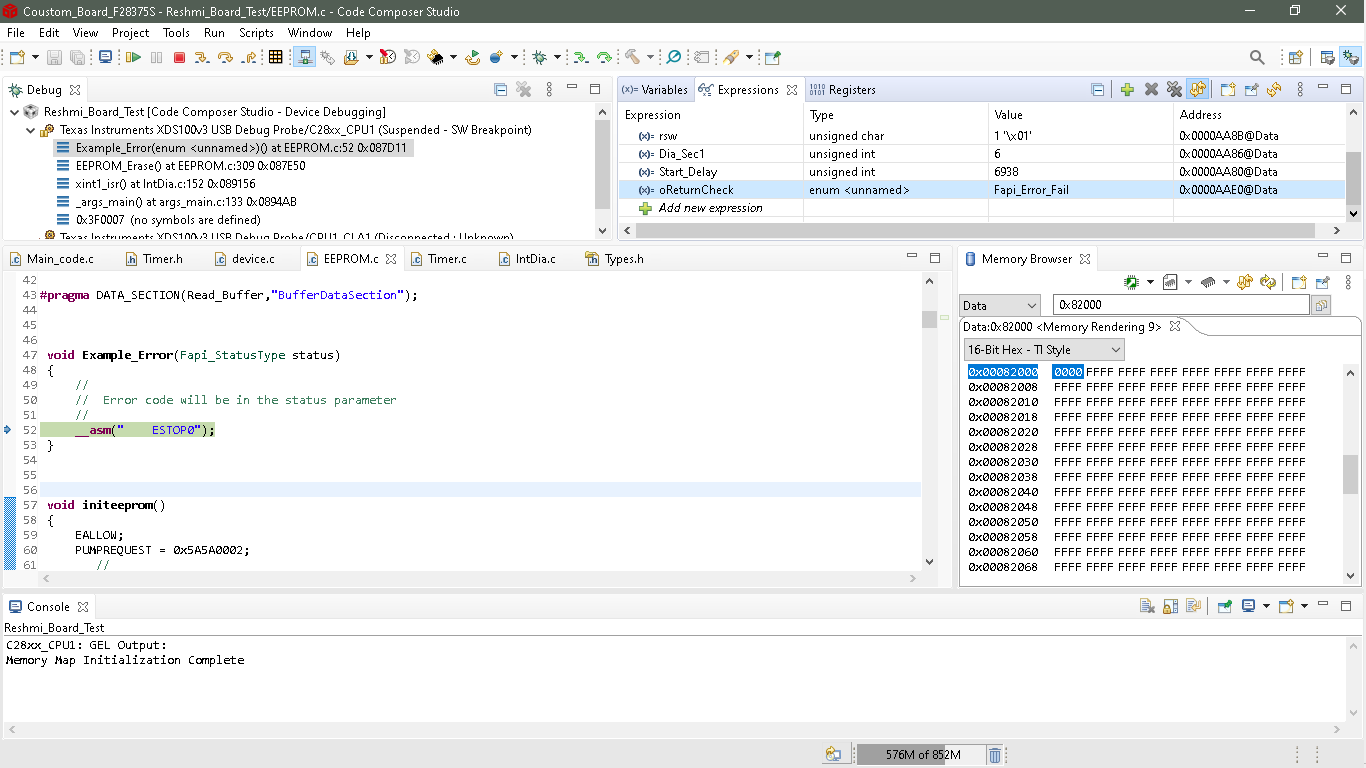

  • Vamsi,
    Vamsi Gudivada said:
    memcpy() should be called before calling any functions assigned to .TI.ramfunc section.
    I have added in my coding before calling the function , now i getting an error Fapi_Error_Fail .....
    Thanks &Regards,
    Rani
  • Rani,
    Based on the address (0x3FE493) at which your application halted (based on your first post in this thread) - your application is hitting an ITRAP.  Hence, I suggested to call the memcpy().  Now that you are not hitting the ITRAP, you can debug further.
    To debug further on why you are receiving Fapi_Error_fail, you need to debug further to know which flash command is failing.  Once you know the function that is failing, you can read the flash API guide or the flash API FAQ that I provided you in other posts earlier to know the debug suggestions.
    Please check which flash API function is failing and we can discuss from there.

  • Rani,
    Just to clarify: The title of this thread says that the issue is with erase command.  But, erase command does not return Fapi_Error_fail. Hence, I suggested you to debug further to identify the actual function that is causing the failure.
    Thanks and regards,
    Vamsi
  • Vamsi,
     After comment bellow statements from my code its works fine now.
    #pragma CODE_SECTION(EEPROM_Write,"TI.ramfunc");
     #pragma CODE_SECTION(EEPROM_UpdateBankStatus,"TI.ramfunc");
     #pragma CODE_SECTION(EEPROM_UpdatePageStatus,"TI.ramfunc");
    Thanks & Regards,
    Rani
