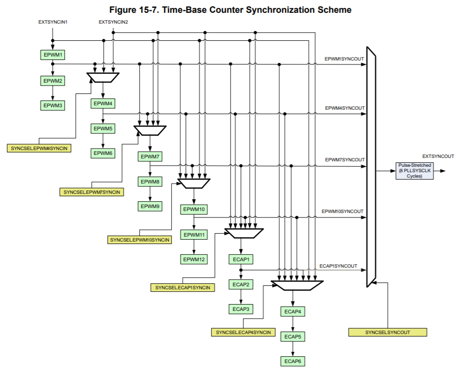

Hi
I am using the example code PWM up_down  for generating PWM signals. I am now trying to generate a phase-shift between few PWM signals, which is not coming out to be as expected.
I am using ePWM3, ePWM 4, ePWM5 and ePWM6.
I want phase-shift X between ePWM3 abd ePWM5, and similarly phase-shift X between ePWM4 and ePWM6. I have attached the code for your reference here.
I have enabled PHS in TBCTL, loaded TBCTR with TBPHS value. The problem I am having is that there is always a minimum phase shift Y even if I load the TBCTR with phase value zero.
Kindly help me rectify this issue.
1. How to generate the required phase shift between ePWMs?
2. How to generate the phase shift between ePWMs which are not in the same ePWM tree, e.g. ePWM 4 and ePWM12?

    While I take a look at your code please take a look at our synchronization example. This example was written to demonstrate how to configure ePWM using the synch chain and phase shift.
    For ePWMs that are not in the same tree please refer to the figure below. You can then set the ePWM10 syncin MUX to the output of ePWM 4 and then set ePWM10 and ePWM11 as pass-through to get ePWM12.

    Yes there is always a Y (I believe Y=2) delay, so you write your TBPHS value with TBPSH-Y.
    You need to be puzzle solver with your EPWM selection. Select the ones that can be synced together in the chain from the diagram. No chain longer than 4.
