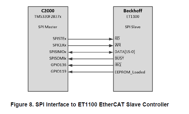

  • First one is a hardware question :
    Is this mandatory to connect /IRQ and EEPROM_Loaded from the ET1100 ? I've read on Piggyback datasheet that it wasn't mandatory..
    If yes, on which GPIO have I to connect these 2 signals ?
    Currently, these signals are available on TMDSCNCD28379D, but I'll use later a TMS320F28379D in PTP package, so GPIO119 & GPIO136 won't be available.

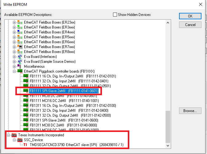

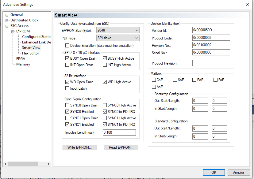

    - TwinCAT found the piggyback ; I can write on the EEPROM, but which binary file have I to write ?
                          - The piggyback binary file for SPI (FB1111 SPI-Slave 2xMII (FB1111-0141-0601))
                          - Or I have to create a binary file linked to the F28379D with the SSC Tool ? (in the picture below, I've created a binary file for the TMDSECATCNCD379D, but I don't use this board, it was just to try)
On TwinCAT, I'm INIT mode. But I've read on other topics it was ok, because I am not running an EtherCAT slave stack on the MCU yet, is that right ?

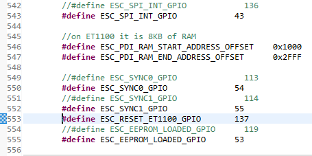

EDIT :
I've made some modifications :
  • I've connected EEPROMLOADED signal to GPIO53
  • I've connected SPI_INTsignal to GPIO43
In etherCAT_slave_c28x_hal.h, I've modified :
//#define ESC_SPI_INT_GPIO            136
#define ESC_SPI_INT_GPIO            43
//on ET1100 it is 8KB of RAM
#define ESC_PDI_RAM_START_ADDRESS_OFFSET    0x1000
#define ESC_PDI_RAM_END_ADDRESS_OFFSET      0x2FFF
#define ESC_SYNC0_GPIO              113
#define ESC_SYNC1_GPIO              114
#define ESC_RESET_ET1100_GPIO       137
//#define ESC_EEPROM_LOADED_GPIO      119
#define ESC_EEPROM_LOADED_GPIO      53
But nothing has changed, I've still haven't SPI signals on oscilloscope, and I can't find "escRegs" on the memory Browser ; what is it address ?

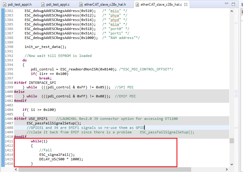

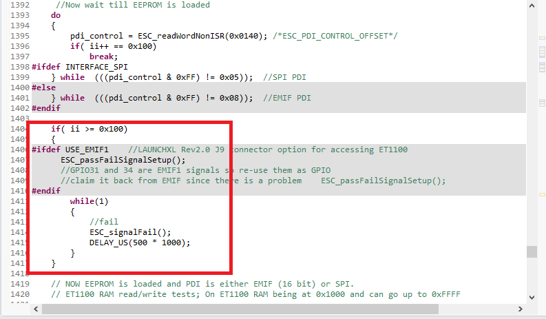

    • When I'm launch the program, I can see a quick SPI frame (with 20MHz clock) at the beginning.
    • 2 leds of the TMDSCNCD28379D are blinking, I'm blocked in this loop I guess :

    You should use the EEPROM file according to the connectivity option you have chosen - EMIF/SPI

  • Hello Ranjith,
    As described in the title, I don't use TMDSECATCNCD379D hardware kit. I'm using TMDSCNCD28379D daughter card and FB1111-0141 piggyback (SPI).

    Please see my responses inline.
    • Is this mandatory to connect /IRQ and EEPROM_Loaded from the ET1100 ? I've read on Piggyback datasheet that it wasn't mandatory.
      If yes, on which GPIO have I to connect these 2 signals ? Does it works with every GPIO ?
    >> SPI_IRQ and EEPROM_Loaded are connected to GPIO136 and GPIO119 respectively on the TI kit. Figure 8 in SPRA1F9 shows this.
    • I can write on the EEPROM, but which binary file have I to write ? File provided by Beckhoff for the FB1111-0141 piggyback ?
    >> The EEPROM content defines ESC and PDI configuration, hence the MCU software need to be in sync. The TI provided EEPROM binary for SPI is matched to the configuration and MCU host software. If FB1111-0141 configuration is very similar, you can try the TI provided EEPROM binary, if not you may have

  • As I explained before, I've made some modifications :
    I've modified also etherCAT_slave_c28x_hal.h.

    In the software, it seems the register ii reaches the value 0x100 and then function ESC_signalFail is triggered.
    Any idea ?
  • To resume :
    • In the "Predefined Symbols", I changed from USE_SPIA
    • Hardware connections :
      • EEPROM LOADED -> GPIO 53
      • SPI_INT  -> GPIO 43
      • SYNC0 -> GPIO 54
      • SYNC1 -> GPIO 55
      • ESC_RESET_ET1100_GPIO -> Not connected
      • SPI_SEL A  -> GPIO 19
      • SPI_CLK A  -> GPIO 18
      • SPI_DO A  -> GPIO 17
      • SPI_DI A  -> GPIO 16
      • GNDs and 5V supply
    • When writing in memory, I've tried FB1111-0141 binary file, and then TMDSECATCNCD379D binary file ; changes nothing.
    Do you know why the program stops at the specific do-loop mentioned in the previous question ?

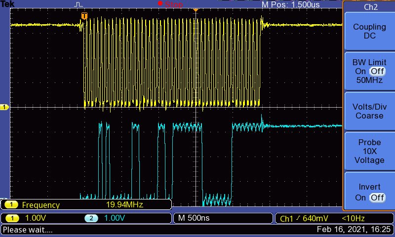

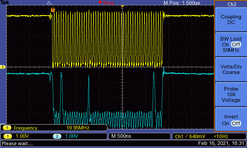

  • When you say the SPI signals are not very clean? What do you mean exactly?
  • Hello Gus,
    This is SPI_CLK and SPIMOSI signals :
    This is SPI_CLK and SPIMISO signals :
    When I execute void ESC_readSPI function (in ESC_setupPDITestInterface() ), SpixRegs->SPIRXBUF is empty, that means we receive no / bad datas ?
    Maybe we can reduce the frequency ?
  • I've used pdi_test_app_spi.bin, as explained in SPRUIF9, but it doesn't work :
    What's the difference between a binary file (.bin) and a xml file ?
    So as explained SPRUIF9, I used pdi_test_app_spi.bin, and I used a better shielded cable to connect F28379D to FB1111-0141 piggyback.
    Now, the program doesn't stops anymore in the specific do-loop mentioned in the previous question. Maybe the issue came from the SPI signal due to the first cable I used.

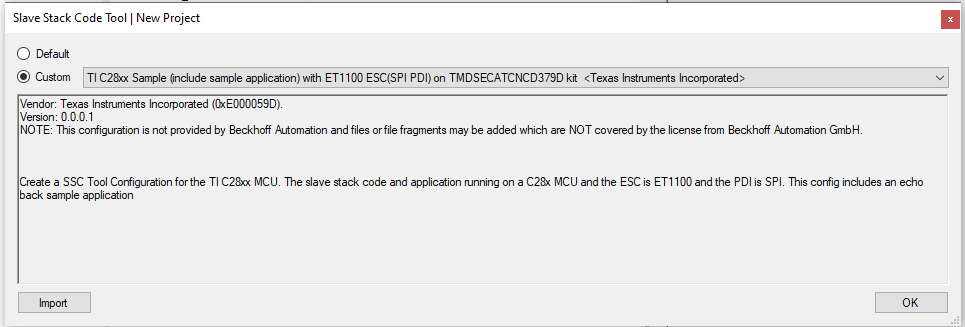

    As I explained before, "TMDSECATCNCD379D_EtherCAT_Solution_Ref" is working. Now I want to develop my own application.
    In SSC, I used this configuration (see below) and create a new application (.xlsx file), same than in SPRUIG9 (sheet 21-22).
    In TwinCAT, state is "OP", so it's working. I can modify values in TwinCAT, values are changing on CCS.
