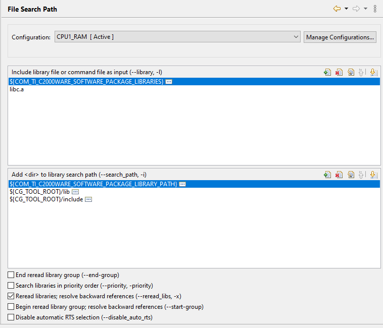

    The picture did not came through. If you open project setting - Linker option, you should see the linker command. Here is the screen-shot from one of my project.
  • Thanks Santosh,
    Is this where the path is set or just a reporting dialogue? The box title is "Summary of flags set:" so it is a little misleading.
    If I delete this portion will it only look in the project directory for the *.cmd files? And does this also apply to the other paths? I would like to have all the necessary files in the project directory for portability.
            Thanks again,
                  Dave
  • David,
    The linker setting, you can set the Linker Include File (upper-pane) and Linker file-path (bottom pane).  In the summary, it displays all the linker include-path (just for review)
    Yes, if you delete the cmd file from linker include file, then it expects .cmd file in the local folder. It will be true for all files.

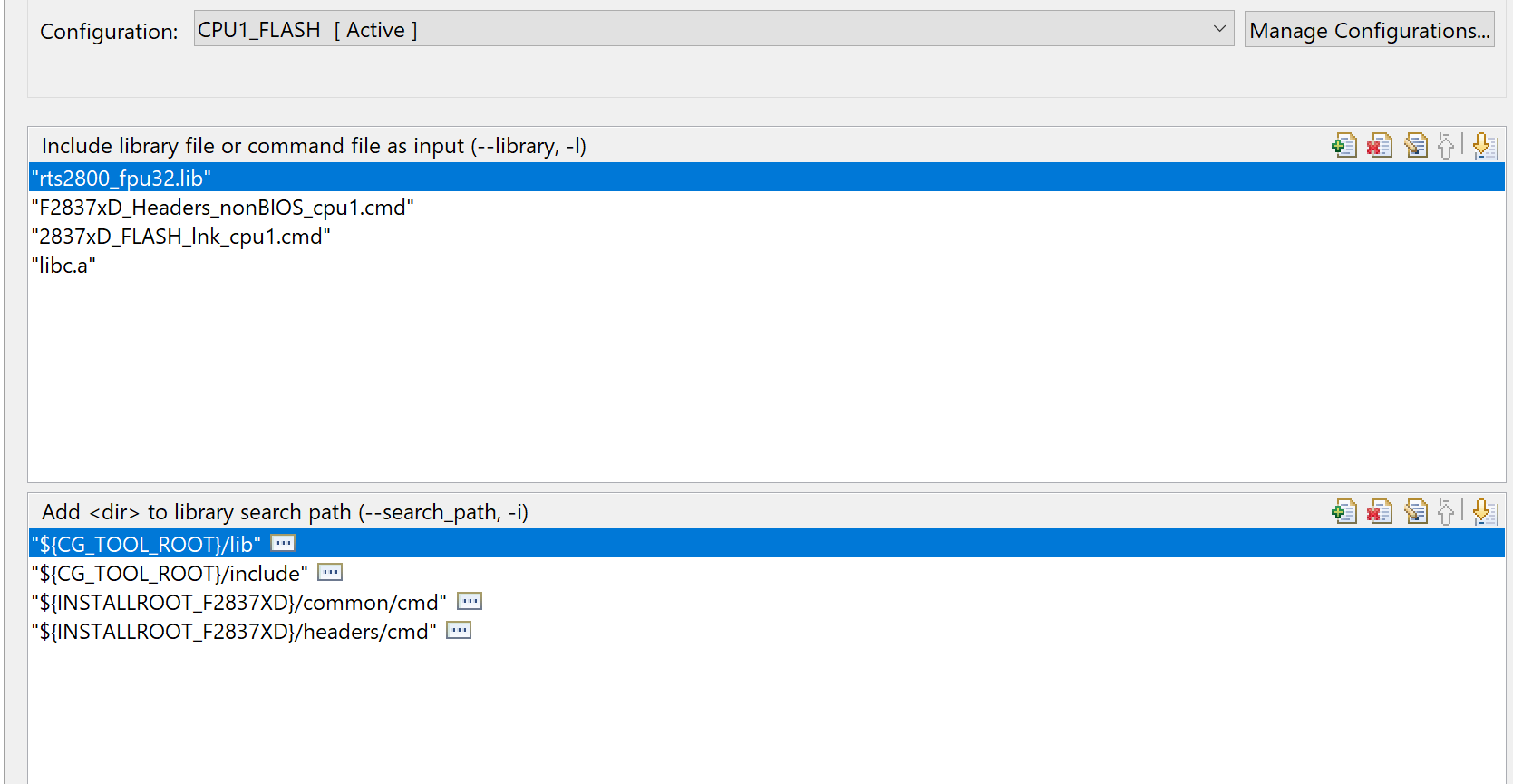

    I went back through the Linker File/Path and removed everything that did not make a difference. I was left with 2 paths, one I believe is needed for the libc.a file. I looked in the remaining two paths for the F2837xD_Headers_nonBIOS_cpu1.cmd file and did not find any. So I assume the path is set somewhere else, maybe in the general include files. Is this possible? I have included the 2 scenarios of what works and what doesn't
               Thanks again
                   Dave
    Links5.docx
  • Hi Dave,
    In the second scenario, what happens if you remove the ""${INSTALLROOT_F2837XD}/F2837xD_headers/cmd" from the project settings?
    I don't think so the general include paths will include the cmd file.
    Best Regards
    Siddharth
  • We then get the following errors Siddarth. Oddly enough, if F2837xD_Headers_nonBIOS_cpu1.cmd is excluded from the build, we only get about 100 warnings, no errors.
  •  Hi Dave,
    In the second scenario, do you have the linker command file "F2837xD_Headers_nonBIOS_cpu1.cmd" file available both in the include path "{INSTALLROOT_F2837XD}/F2837xD_headers/cmd" as well as in the project directory.
    If so, can you remove it from the linker command from the include path and check if it resolves the issue.
    Best Regards
    Siddharth
  • Siddharth,
    I think I have found the problem. The F2837xD_Headers_nonBIOS_cpu1.cmd file that was in the project folder was way different than the one I finally located in C:\ti\controlSUITE\device_support\F2837xD\v210\F2837xD_headers\cmd . When I copied the one from v210 into the project folder it built just fine. One of the big problems was trying to figure out the path that the CCS was accessing. The path that shows up when you mouse over the link in the "File Search Path" dialogue seems to go much deeper than where the *.cmd file is. I just started backing up from that until I found it
