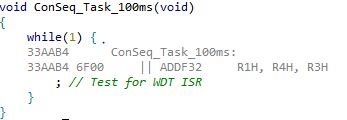

Here is the test code that will trigger the watchdog timeout.
Now, program flow will jump to the WDT ISR from the address 0x33AAB4

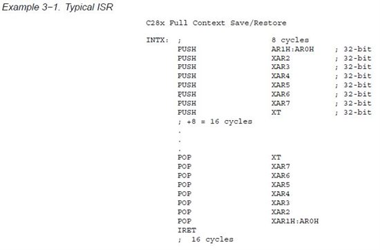

  • Thanks Lori (and also thanks to Andreas)
    As I mentioned in my question, your SPRU430 shows it.
    Which means that "7th save operation" will do the saving process of return address.
    And on next page in your SPRU430,
    As I know, above context saving process is included in your start-up code and I can't modify it.
    So, from above two pictures, I concluded that the address where the WD timeout is occurred should be stored in XAR7.
    (Unless my WDT ISR code does not use XAR7 register.)
     If my understanding is totally wrong, then how can I get that address?
    I'd like to store it without emulator. (Actually, I'll check that information through the CAN or SCI communication)
  • Hi Ted,
    I am sorry to notify you but your understanding it totally wrong.
    The context and return address are stored on stack. Table 3-3 only says that return address is stored on stack on seventh(7) cycle since interrupt has been acknowledged by CPU. Example 3-1 shows how to store additional CPU registers (on stack), that were not automatically by the CPU. Beware that the example is only valid for non-FPU targets.
    Where exactly on the stack depend on your interrupt entry code. If you do not have any extra code then return address is on top of the stack. But if you have some interrupt entry code locating return address placement on stack becomes somewhat more difficult. If your interrupt functions are written in assembly it is easier, because C-compiler automatically generates this code, and the generated code differs for FPU and non-FPU targets and is different wheather you have any function calls or not within your interrupt routine. And you are correct on the fact that you can not modify compiler generated interrupt entry code.
    Lory's warning about not modifying CPU registers with inline assembly deserve a little comment. While I completely agree with her it is smart to check your code against C/C++ compiler register conventions (SPRU514 -still from 2007, chapter 7.2) in order to assure that your inline assembly does not break any of the conventions.
    How can you access the data on stack is a different issue, which if I recall correctly has already been covered somewhere on these forums (but maybe it was on previous forums which I don't think were archived)
