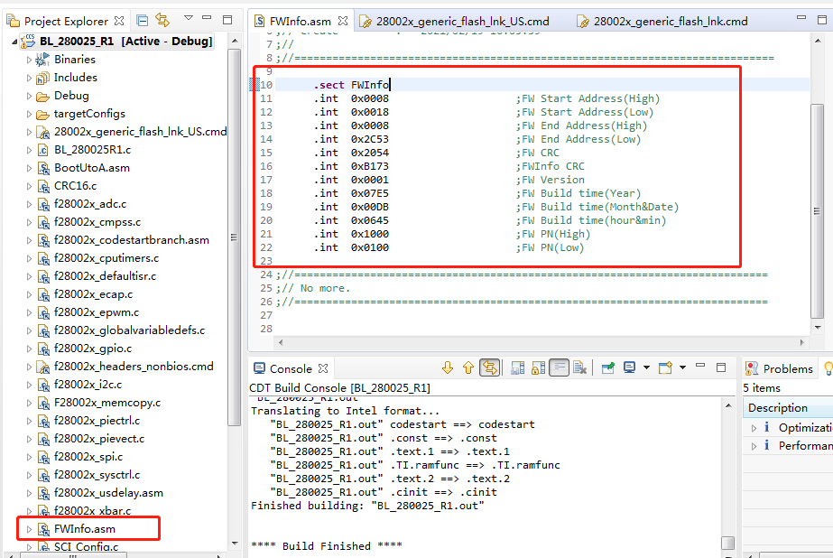

customer uses F280025, they need to change output file from  COFF to EABI, but FWInfo.asm not show at the designated address.
it should show at 0x080002,but hex is empty,it goes to 0x080018:
they use the same process for F28034 and F280049 and never meet this issue.
the attached is CMD and ASM.FWInfo.asm
