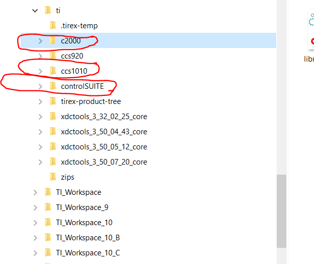

I am trying to use TI CCS with Helix Perforce as a project manager and multi-user tool. There are several problems I am trying to work through.
The first is delineating which files can be part of the CCS structure (such as C2000 files) and which are ones that are user owned and modified. Of particular interest are those files that I take from the CCS file structure and then modify to meet the application needs. These files now are not referenced by the standard path but now become part of the project file structure. A good example are the *.cmd files
Then, knowing what files are user modified and which ones can be from the CCS file structure, how do I
a) Set these files up in CCS to compile properly
b) Set up CCS and Perforce so that only the user modified files are under configuration control
There is a lot of documentation for CCS, and I would imagine somewhere this is addressed, but it is tough for me to find it. I would be happy to review any documentation if you could tell me where to look.
