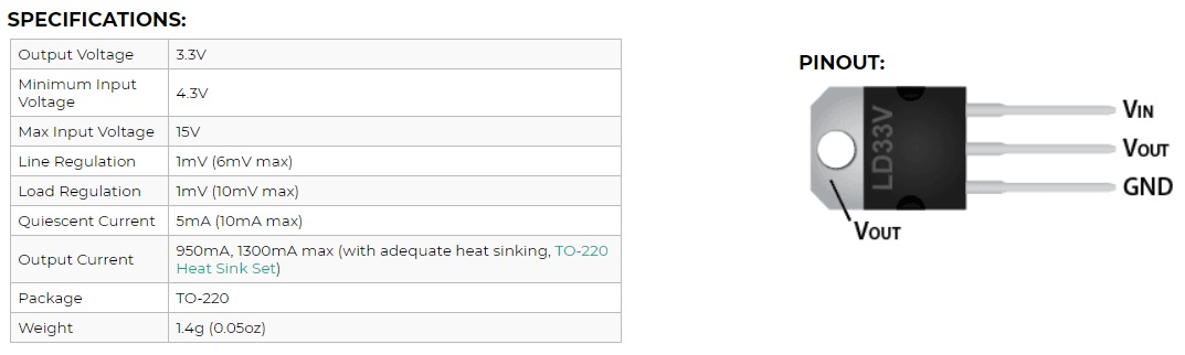

  • Hello Kevin,
    3.3V supply works with the circuit below.
    It does not show the current and I could not measure it with my multimeter but if you mention 500mA current levels, maybe curent is way too little for the kit's requirements.
    When energized, after some seconds, D10 blue led becomes active.
    This led lights when the temperature has decreased, right?
    Thank you.
